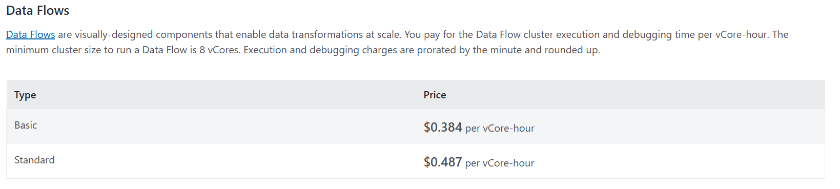

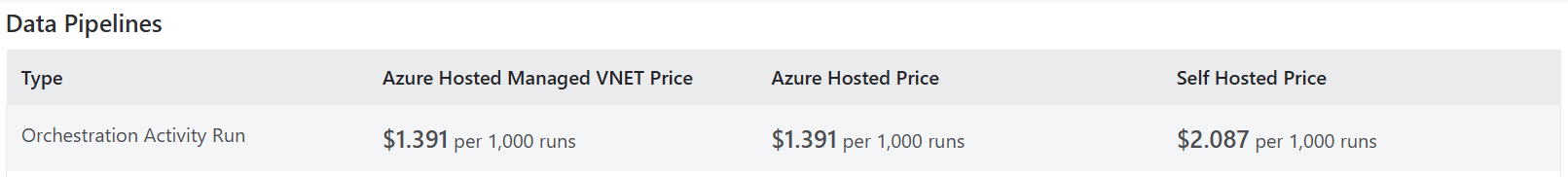

I am reading what it looks like there two factors to the cost of each child pipeline:
  1. of activities
  2. of vCore-hour
When estimating costs for each mapping dataflow, should I just go with
5 activity runs @ ($1.391 per 1000 runs) = $0.007
consumed vCore-hour of 0.6972 * $0.384 = $0.268
Total cost for Child pipeline: $0.2747
Imagine all 12 pipelines have identical consumption then it should be
12 child piplines@ $0.2747 = $3.296
12 activity runs @ ($1.391 per 1000 runs) = $0.016
Total cost for the Parent Pipeline = $3.312

Your understanding of estimating the costs for running mapping data flows within a parent pipeline seems mostly correct.
Here’s a breakdown to ensure clarity:
Activity Runs Cost:
  • 5 activity runs @ $1.391 per 1000 runs = $0.007 per child pipeline.
  • For 12 child pipelines: 12 * $0.007 = $0.084.
vCore-Hour Cost:
  • Consumed vCore-hour of 0.6972 * $0.384 = $0.268 per child pipeline.
  • For 12 child pipelines: 12 * $0.268 = $3.216.
Total Cost for Each Child Pipeline:
  • $0.007 (activity runs) + $0.268 (vCore-hour) = $0.275 per child pipeline.
Total Cost for All 12 Child Pipelines:
  • 12 * $0.275 = $3.30.
Total Cost for the Parent Pipeline:
  • $3.30 (child pipelines) + $0.084 (activity runs) = $3.384.
So, the total estimated cost for the parent pipeline running 12 child pipelines would be $3.384.
