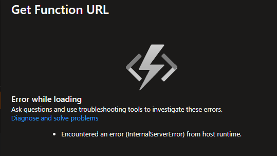

Azure Function with Bicep: Deploy Completes Successfully, But Function URL Returns 500 Error
Andrea Rubino 0 Reputation points
2024-11-29T14:10:22.39+00:00
I'm deploying an Azure Function using Bicep and Azure Pipelines. Both the infrastructure deployment and the pipeline execution complete successfully. However, when I navigate to the Azure Function in the portal, I see my test API listed as expected. But when I try to retrieve the API URL (the one with the function code), Azure returns a 500 Internal Server Error.
mL5kRvYD
Additionally, I noticed an inconsistency with the deployment: although the function is linked to a storage account and deployed using zip deployment, the storage account's container doesn't contain the expected metadata or artifacts. This doesn't align with what I would expect from a typical function deployment.
Below are the relevant files for the setup:

What I've tried:
Tested Storage Account Connectivity: I ran nslookup and curl from the Kudu console to check if the Azure Function could reach the storage account. Everything seems fine; the storage account is reachable without any issues.
Quadruple-Checked App Settings: I went through the AzureWebJobsStorage connection string in the function's app settings multiple times. It’s set up correctly, using managed identity authentication like this: `DefaultEndpointsProtocol=https;AccountName=
Azure Functions
Azure Functions
An Azure service that provides an event-driven serverless compute platform.
Azure Storage
Azure Storage
Globally unique resources that provide access to data management services and serve as the parent namespace for the services.
  1. Pinaki Ghatak 5,690 Reputation points Microsoft Employee Volunteer Moderator
    2024-12-04T10:53:09.55+00:00
    Hello @Andrea Rubino
    Here are some additional steps you can take to troubleshoot the issue:
    1. Check the logs: You can check the logs for the Azure Function to see if there are any errors or exceptions being thrown. You can access the logs from the Azure portal by going to your function app, selecting "Functions" from the left-hand menu, selecting your function, and then selecting "Logs" from the top menu.
    2. Check the storage account firewall settings: Make sure that the storage account firewall settings are configured correctly to allow traffic from the Azure Function. You can check this by going to the storage account in the Azure portal, selecting "Firewalls and virtual networks" from the left-hand menu, and then making sure that the "Allow access from" setting is set to "Selected networks" and that the IP address of the Azure Function is included in the list of allowed IP addresses.
    3. Check the storage account access keys: Make sure that the storage account access keys are configured correctly in the Azure Function app settings. You can check this by going to the Azure Function in the Azure portal, selecting "Configuration" from the left-hand menu, and then making sure that the "AzureWebJobsStorage" setting is set to the correct connection string for the storage account.
    4. Check the storage account container permissions: Make sure that the storage account container permissions are set correctly to allow the Azure Function to access the container. You can check this by going to the storage account in the Azure portal, selecting "Containers" from the left-hand menu, selecting the container that should contain the deployment artifacts, and then selecting "Access policy" from the top menu.
    5. Make sure that the "Public access level" is set to "Private (no anonymous access)" and that the "Allowed access level" is set to "Blob (anonymous read access for blobs only)".
    I hope that this response has addressed your query and helped you overcome your challenges. If so, please mark this response as Answered. This will not only acknowledge our efforts, but also assist other community members who may be looking for similar solutions.
