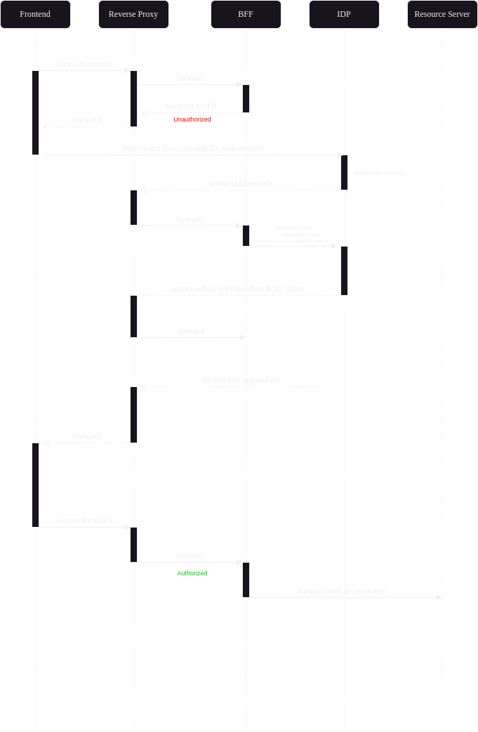

I currently try to create a Website where i'm amble to login with microsoft (Microsoft Entra ID) and also get data from minecraft if the user has minecraft connected to his account.

The problem that i now have, is that the access token is a Opaque Token.
There is no token introspection endpoint to validate the token neither any documentation to change the access-token response to a JWT instead.
My Bff has all 3 tokens stored and can authenticate requests, but my internal api's authenticate request via access-tokens, so here i'm not able to handle the forwarded access-token from the BFF.
Here is my flow:
azure-flow
