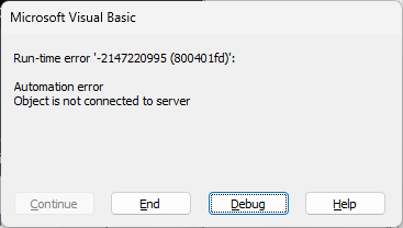

Error Message below:

  1. Courtney Owen 0 Reputation points Microsoft Employee
    2025-02-03T18:50:56.7466667+00:00
    @William Sessums I see that a bug was opened for this issue and the Access team will look into it to see if we can determine what's going wrong here.
    -Courtney Owen
    Access Engineering Team
