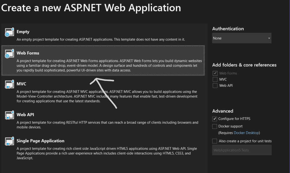

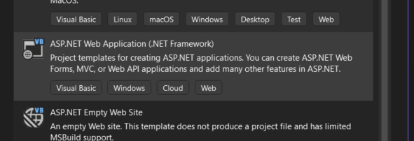

    As for creating a menu? I suggest you create a new web site, and choose the default template. It will then create a project with a menu bar, and you can then modify that existing menu bar to/for your needs. In most cases, the markup created is a "bootstrap" menu bar, and it has a typical web site look and feel to such menu bars.
    You don't mention what kind of web project you are creating, but a guess would be a webforms asp.net framework project.
    Hence, this option:
    And after above, then this:
    And the final result is thus a web page with a menu bar like this:
    So, now you can look at, change and modify the created menu bar for your needs. So, in most cases, it is best to create a web site with a "built-in" navigation menu bar that be pre-created for you.
    Thus, you can "study" that menu bar, and even copy it, but in most cases, I found it just makes sense to go and modify the "default" menu bar for your needs.
