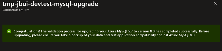

We are trying to do a major version upgrade of Azure MySQL flexible server 5.7 -> 8.0.
I have removed all application databases for troubleshooting the issue.
The azure validation results show a successful result.
I get back the following error without any extra information, except to check database compatability with the upgrade checker:
{"code":"DeploymentFailed","target":"/subscriptions/{SUBSCRIPTION}/resourceGroups/{RG}/Microsoft.Resources/deployments/UpgradeMySqlFlexibleServer_68kdkdo1566bafe3","message":"At least one resource deployment operation failed. Please list deployment operations for details. Please see https://aka.ms/arm-deployment-operations for usage details.","details":[{"code":"ResourceDeploymentFailure","target":"/subscriptions/{SUBSCRIPTION}/resourceGroups/{RESOURCE_GROUP}/providers/Microsoft.DBforMySQL/flexibleServers/tmp-jbui-devtest-mysql-upgrade","message":"The resource write operation failed to complete successfully, because it reached terminal provisioning state 'Failed'."}]}
