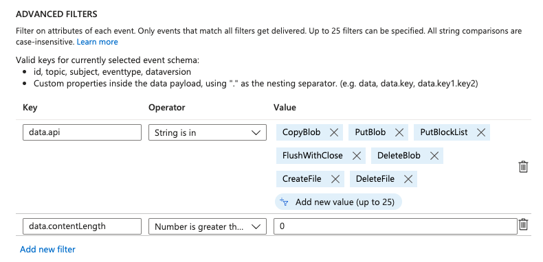

My event grid subscription is set to the filters values you can see in the first attached image. With the filters below my pipeline runs fine.Screenshot 2024-12-04 at 14.53.25

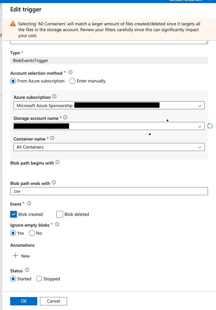

Then, if I change the setting of my trigger in ADF (see the 2nd picture attached) the filter values (3rd picture) change on their own without warning. This breaks my flow and the triggers don't work anymore. What is going on?Screenshot 2024-12-04 at 14.54.01

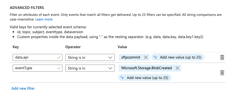

This happens when I change "Ignore empty blobs" to "Yes" and the new filter values are:
Screenshot 2024-12-04 at 15.06.21
which break my overall pipeline and the triggers don't run anymore, this happens whether I use the Preview of ADF or not.

    When it comes to SFTP storage events, ADF doesn't add that by default and need to be defined explicitly. This is documented in the below link:
    If you're working with Secure File Transfer Protocol (SFTP) storage events, you need to specify the SFTP Data API under the filtering section too.
    https://learn.microsoft.com/en-us/azure/data-factory/how-to-create-event-trigger?tabs=data-factory#storage-event-trigger-considerations
    If you edit, it is like a re-deployment of trigger which overrides back to default setting i.e. no SFTP related API. Unfortunately, it is by design behavior.
