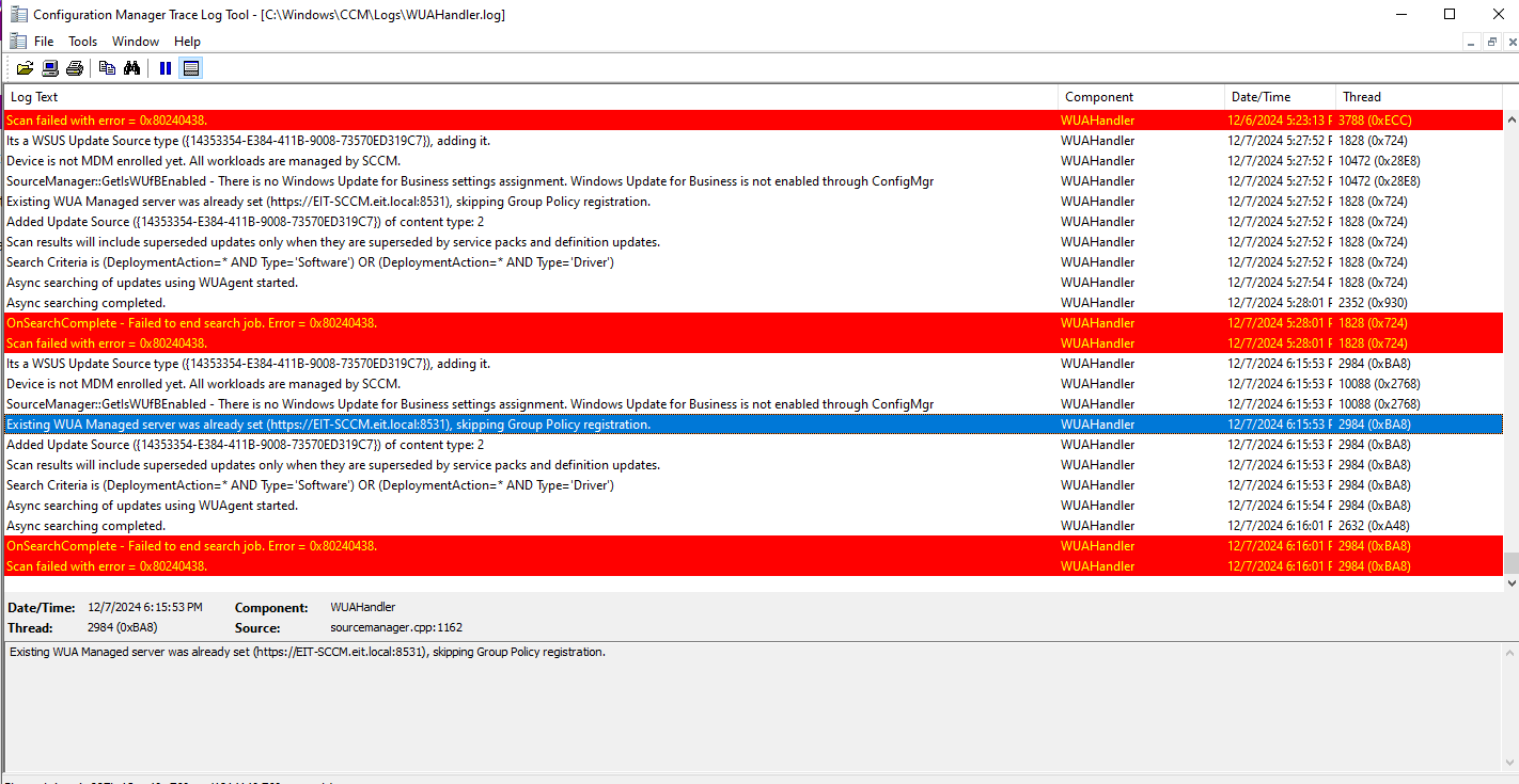

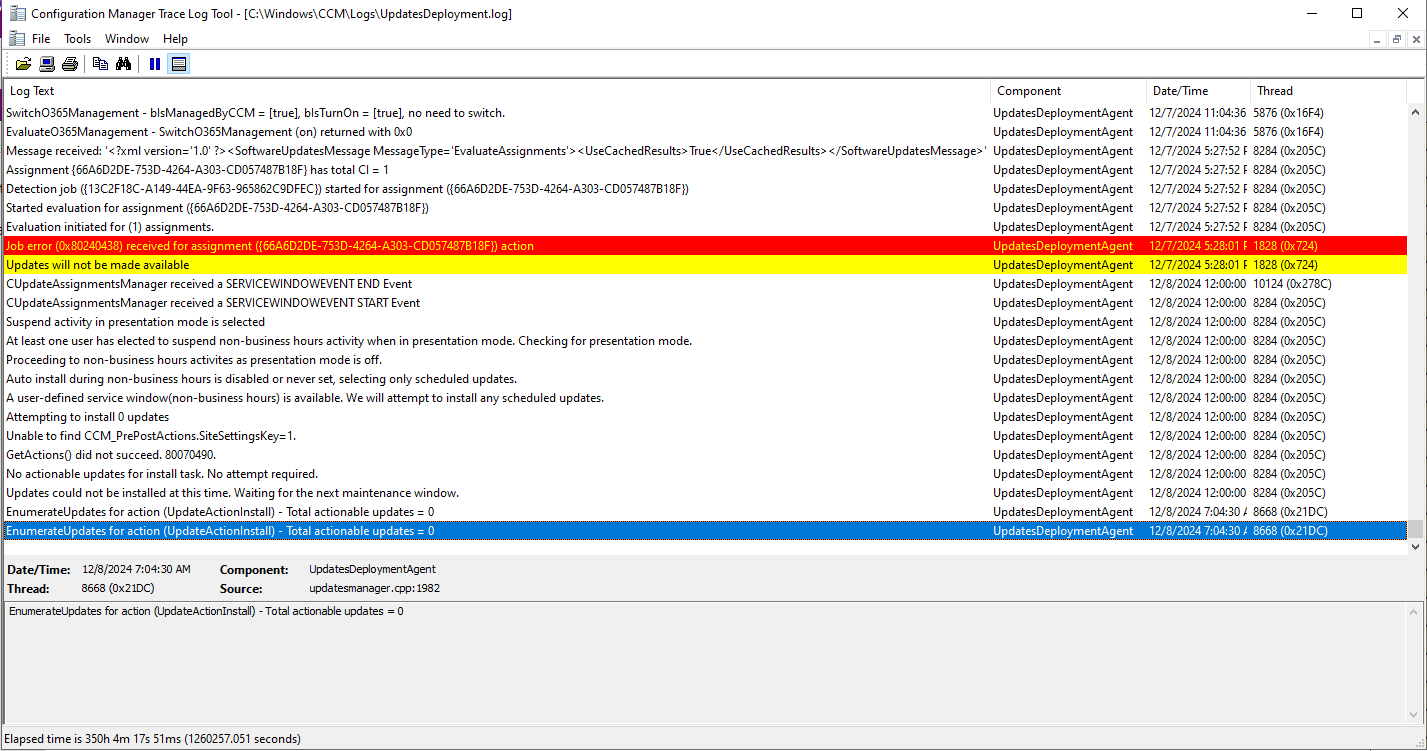

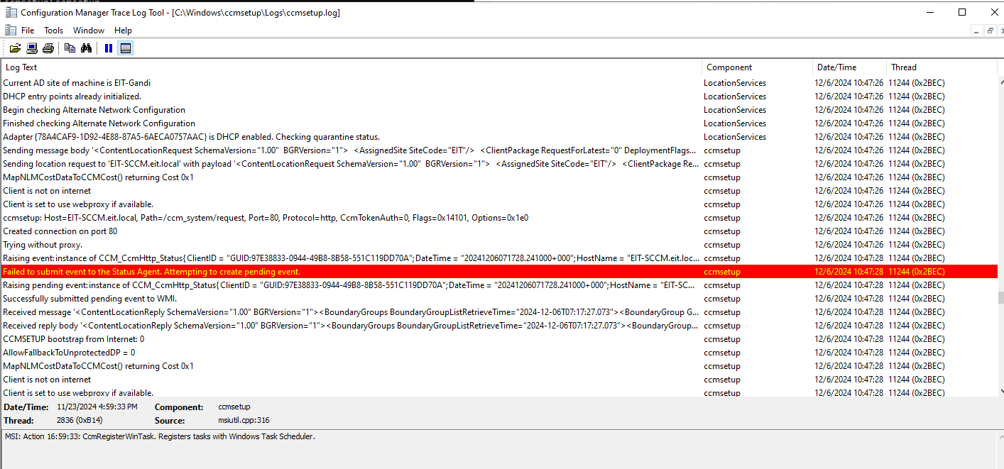

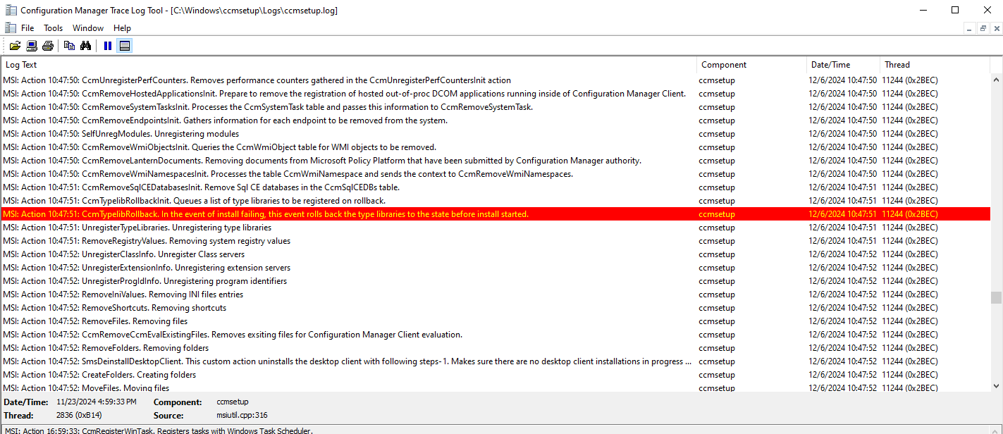

Of course, when installing AGENT on the client, I saw an error in the logs, which I posted a picture of for you, but in the end, AGENT is installed on the client and I can see in the SCCM console that it is installed on the client.Screenshot 2024-12-06 104807.pngScreenshot 2024-12-06 104840.png

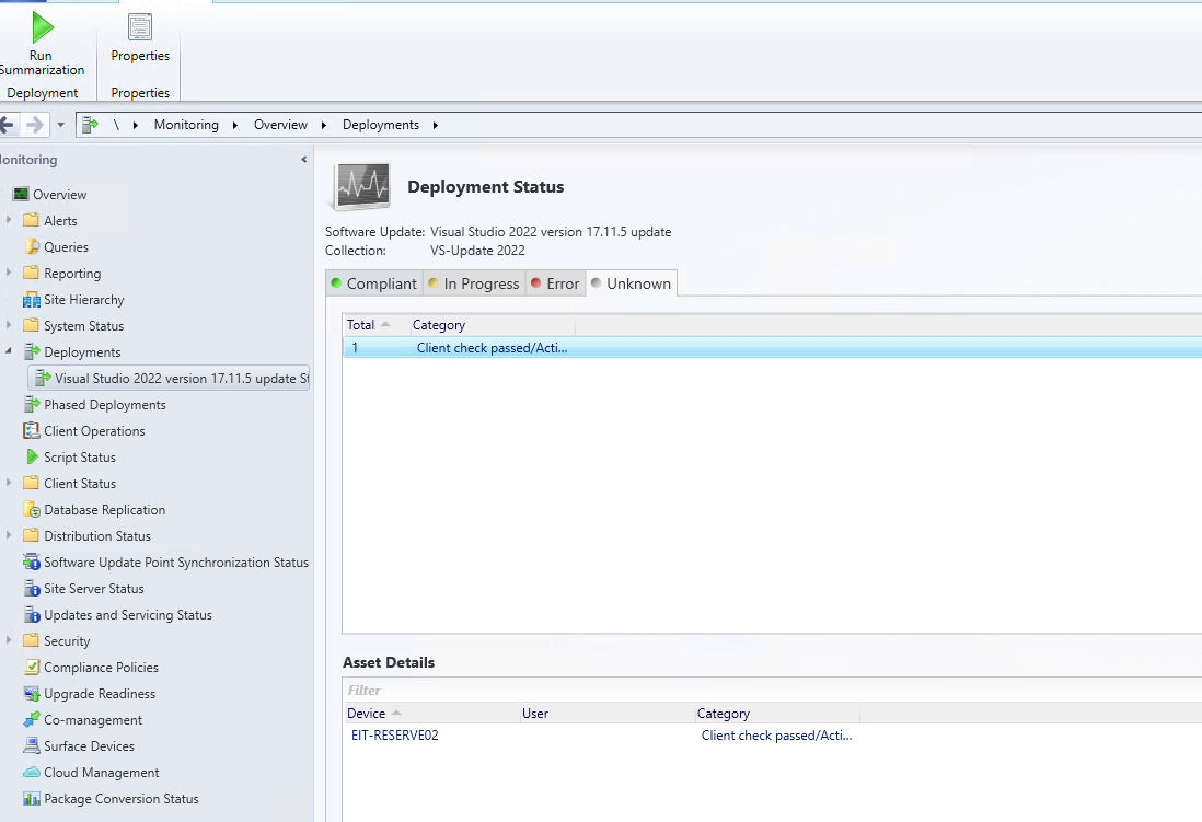

But after deploying the update, nothing happens and the deployment status goes to Unknown.Screenshot 2024-12-06 111121.png

    Agent Logs: Check the logs (CcmExec.log and ClientIDManagerStartup.log) on the client to identify specific errors during installation and communication.

    Update Deployment Logs: On the client, check UpdatesDeployment.log and WUAHandler.log to verify the update process.

    Status Unknown: If the deployment status is "Unknown," check the communication between the client and the SCCM server (Management Point). Verify the client can reach the server's URL.
