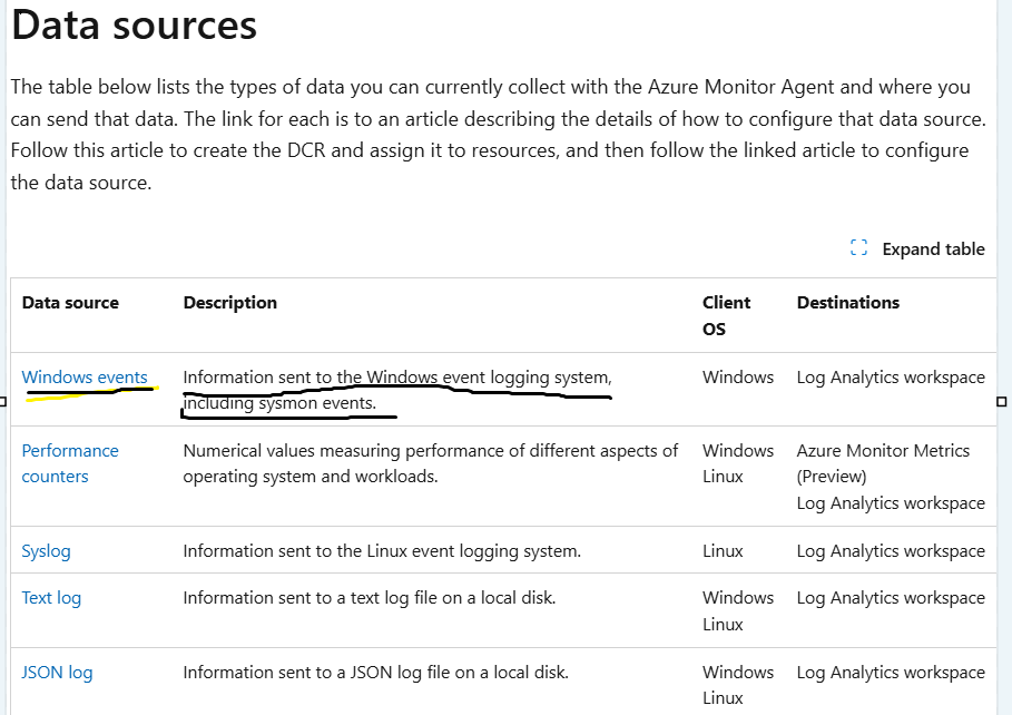

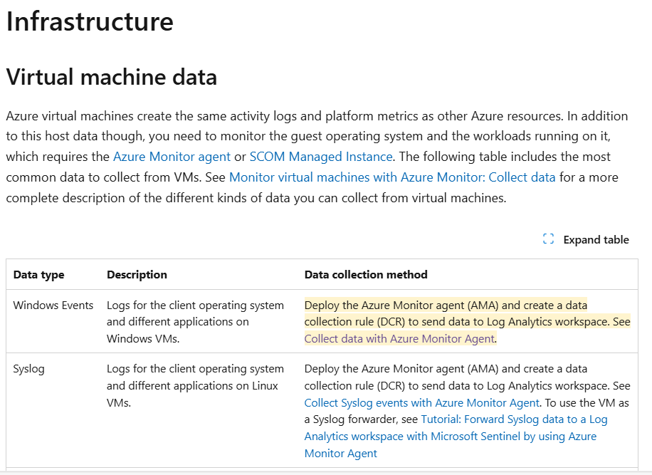

      • 6006: Indicates a clean shutdown. This is the most common event ID for a normal shutdown.
      • 6008: Indicates an unexpected or dirty shutdown. This could be due to a crash, power outage, or forced shutdown.
      • 1074: Logged when an application or service initiates a system restart or shutdown.
      • 41: Indicates a system reboot without a clean shutdown, often caused by a crash or unexpected power loss.
      Refer below MS document for more information: https://learn.microsoft.com/en-us/azure/azure-monitor/data-sources
      https://learn.microsoft.com/en-us/azure/azure-monitor/agents/azure-monitor-agent-data-collectionUser's imageUser's image
