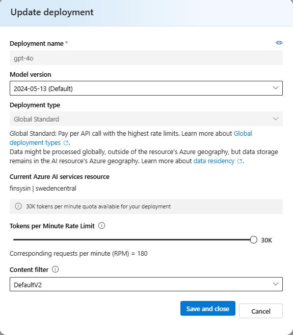

  1. We use the gpt-4o (Global Standard) model, the configured limit is 30k TPM. We checked the settings in the Quotes section, everything is correct.

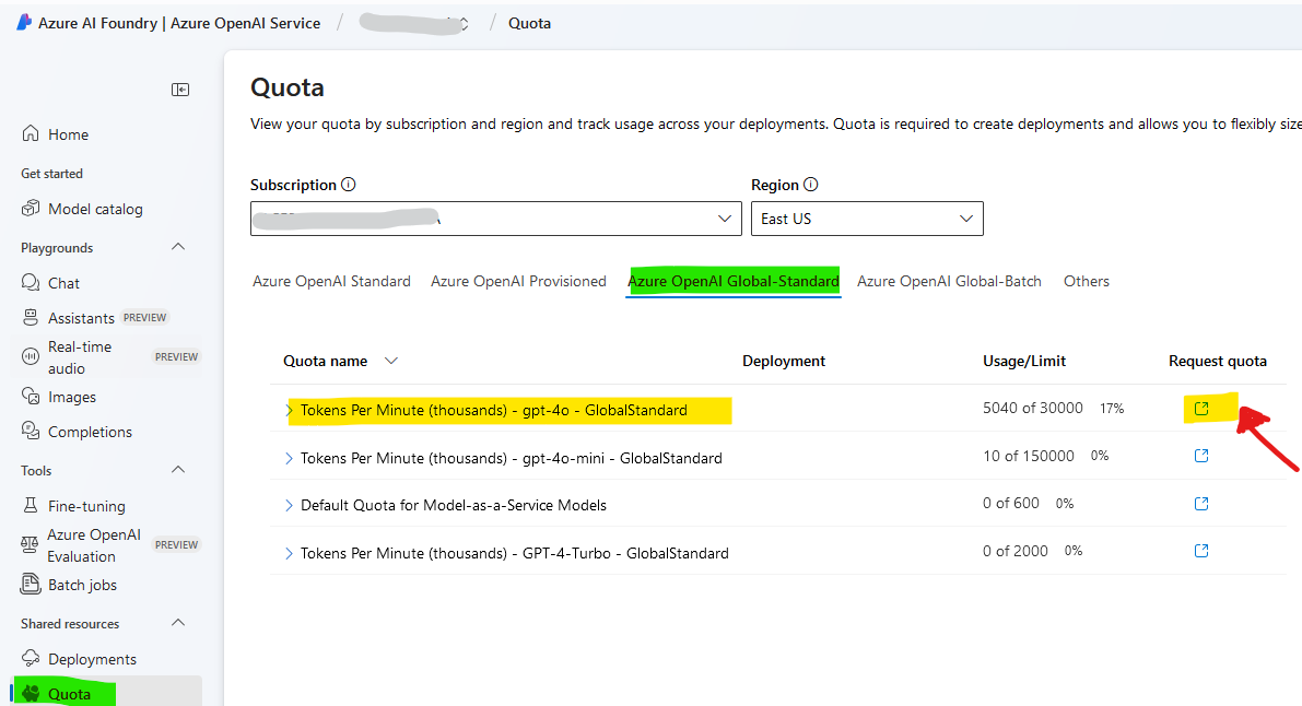

    @Fin Systems Yes, Please increase the TPM quota from the Azure AI Foundry as shown below:
    This will open a quota request form. Use this form to request an increase due to your forecasted usage for Azure OpenAI Service. Microsoft will use the information you provide to assess your usage volume and patterns, allowing us to allocate the necessary GPU capacity to support your work. We will make every effort to accommodate your request; however, allocation is based on our current capacity and future deployments, and is subject to availability.
