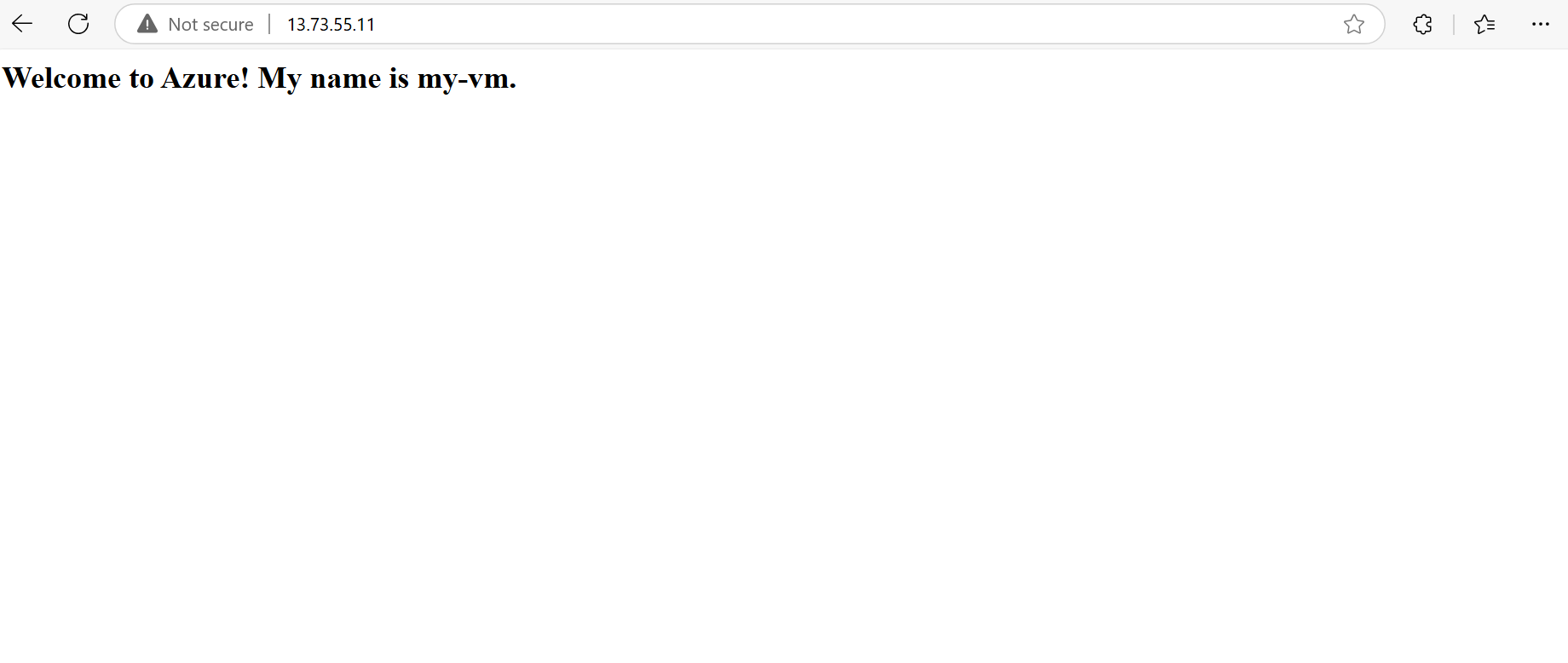

     We also tested it on our end and obtained positive results, as shown in the screenshots:
    Screenshot 2024-12-05 155159
