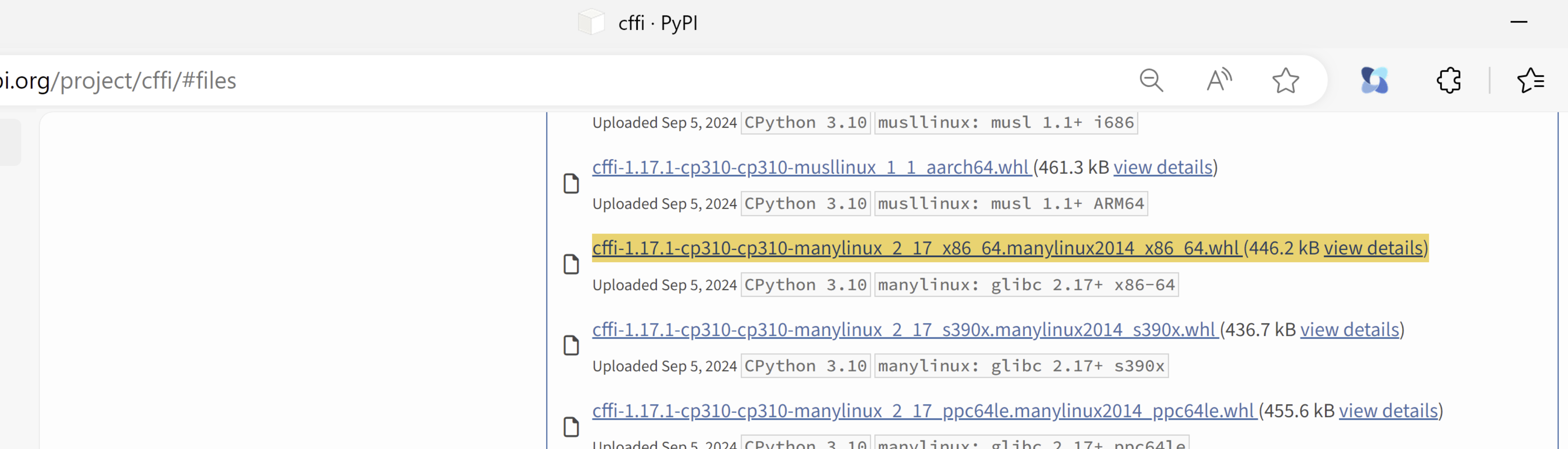

    Short answer: Do not use cp313, use cp310.

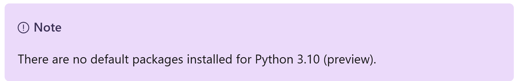

    In the document it is mentioned that you use below format files for Python 3.10. However t seems you are using "cffi-1.17.1-cp313-cp313-manylinux_2_17_x86_64" which is cp313 so it won't work.
    Please use correct file which is present here: cffi · PyPI
    You can refer to this document for Python packages in Azure Automation - https://learn.microsoft.com/en-us/azure/automation/python-3-packages?tabs=py3%2Csa-mi
