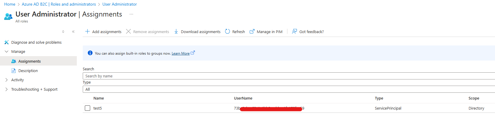

  1. CarlZhao-MSFT 46,376 Reputation points
    2024-12-11T08:06:58.24+00:00
    Hi @Ray Garg
    In addition to the above permissions, the calling app must have the User Administrator or Global Administrator role.
    Hope this helps.
