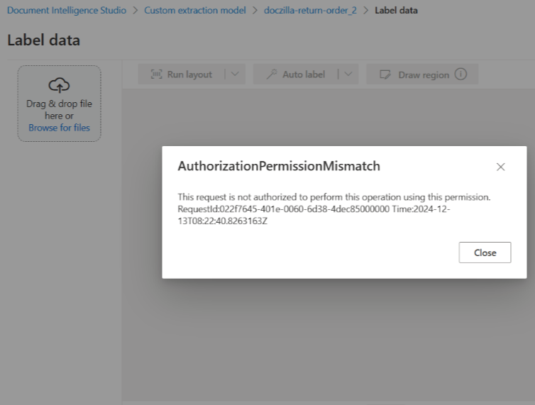

We are facing this issue within load projects in Document Intelligence Studio.
chyba

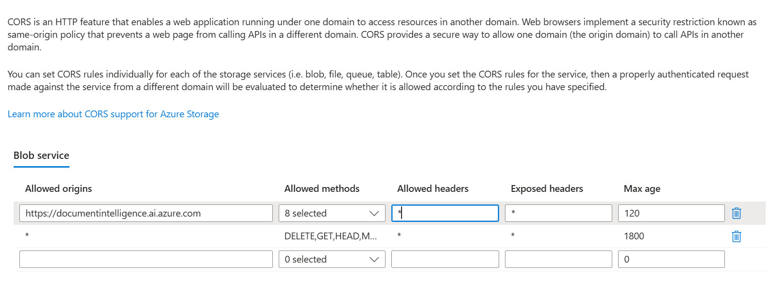

The strange thing is that this error appears randomly and not always. The CORS settings for storage are set according to the documentation.

    I understand that you are getting error when load projects in Document Intelligence Studio with failure to access the blob container. Here are some common troubleshooting steps you can take to diagnose and resolve the issue:
    1. Ensure that your Azure Blob Storage account is properly configured and accessible. If you are using a Shared Access Signature (SAS) to access the storage account, make sure that the SAS is still valid and has the necessary permissions (e.g., "write" permission) to upload files to the container.
    2. CORS rules might have changed, causing issues with your access to files. Review and ensure that the allowed origins, methods, and headers are correctly configured for your blob storage. Double-check that the Access-Control-Allow-Origin header is set correctly and matches the origin of your requests. Also, ensure that other necessary headers like Access-Control-Allow-Methods and Access-Control-Allow-Headers are properly configured.

    5. Verify that you have the necessary permissions to access the storage account and container. You might need Contributor or Owner access to perform certain operations. similar thread for reference - https://learn.microsoft.com/en-us/answers/questions/1616183/document-intelligence-studio
