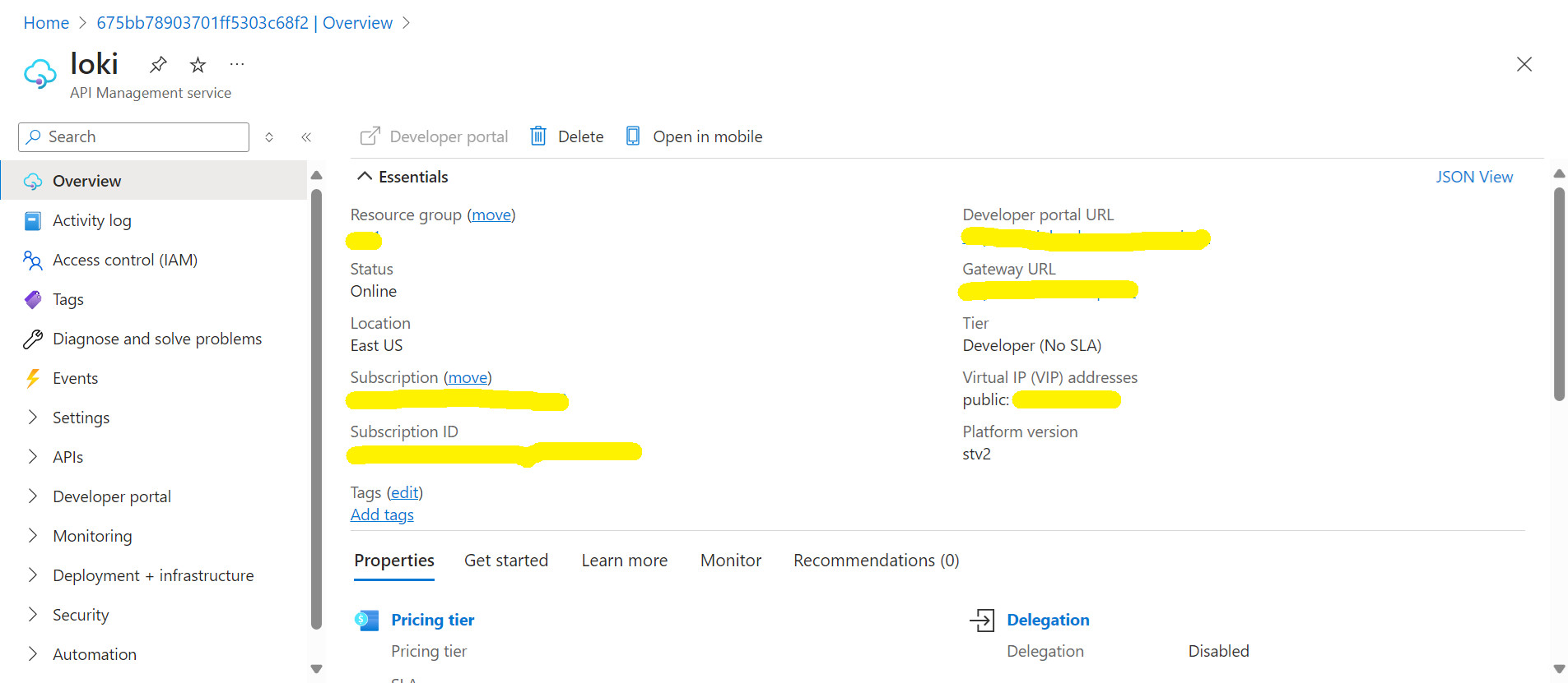

    To check the version of you APIM instance API Management >> overview >> Version, also check the below snap for your reference.
