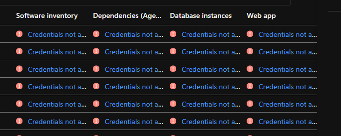

Error Details
Error ID
20000
Error message
Credentials not available.
Possible causes
No credentials have been provided on the appliance for this server.
Most the response talks about 10012 but I need to fix Error 20000 instead of 10012, NOT THE IMAGE SHOWN below

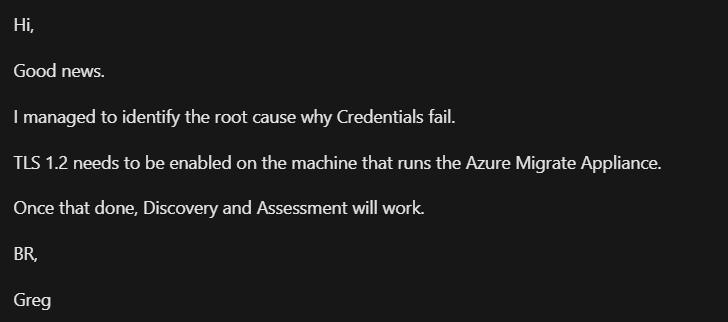

I see one post about fixing after enabling TLS 1.2 but in my case I am using OVA deployed appliance not if TLS 1.2 would fix it
