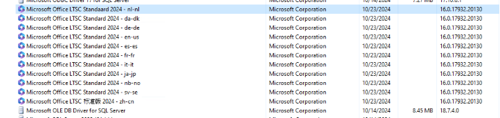

Hi, I've installed 'Microsoft Office LTSC Standard 2024 64-bit' on Windows 10 system. There are 12 languages that I've installed for the respective languages that we support. Unfortunately I'm unable to perform an uninstall of the Office 2024 offline. I'm trying to uninstall each one from Program & Features (Without internet), but getting the below error. Uninstallation works only when connected to Internet. I've tried disabling Firewall settings, Virus & Threat protection etc. This was working fine few weeks back, I'm seeing this issue recently. Any leads please.

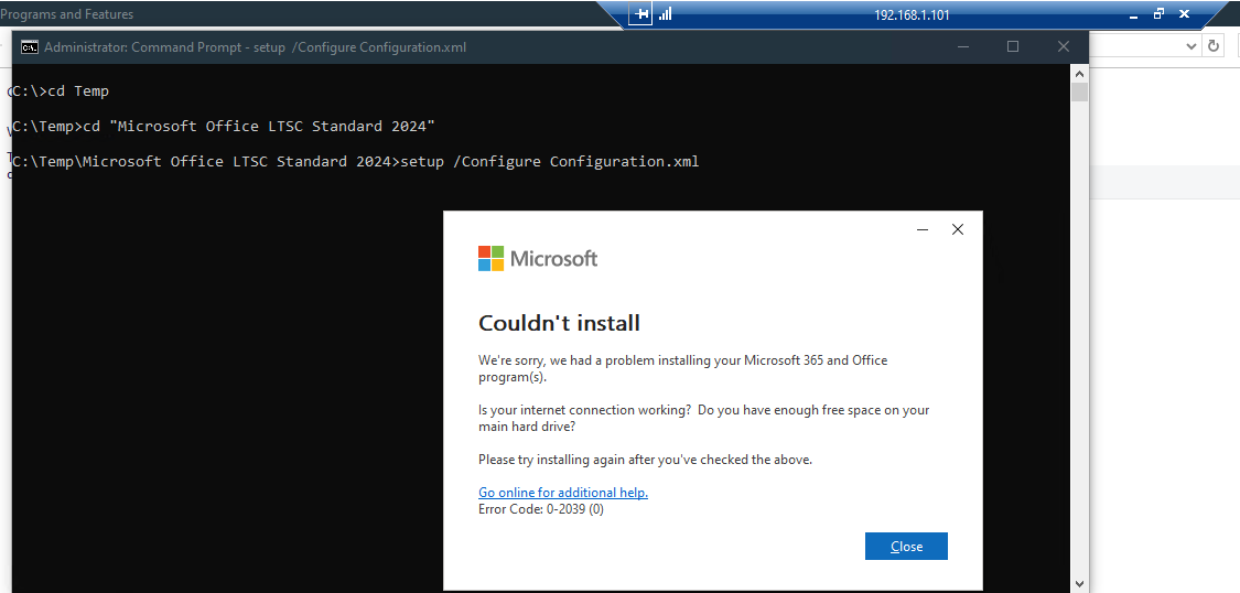

  2. R, Vimal Raj 0 Reputation points
    2025-06-26T08:40:59.64+00:00
    Hello, I'm back to this issue again. The above step didn't work, I tried to do it via configuration.xml file using the <Remove> option but didn't work. Just curious to know if you've tried the above yourself, I see this step mentioned in many places but doesn't seem to work. Does Microsoft allow Office2024 offline uninstall at all ? Coz with internet it works seamlessly.
