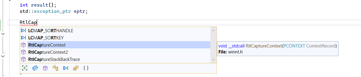

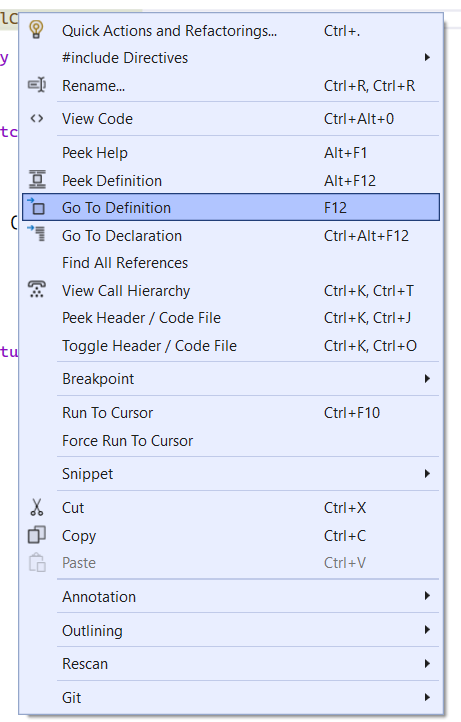

  1. Darran Rowe 2,076 Reputation points
    2024-12-15T23:54:54.1366667+00:00
    Unfortunately, this is one of those circumstances where if you have to ask this question then you are not ready to do this.
    If you really wish to try this though, I seriously suggest that digging deep into winnt.h and trying to make a coherant view of that file is the first stop. The reason why I mention trying to work with winnt.h is because it perfectly highlights all of the problems with the Windows headers. If an example of what I mean is required, find the definitions of the CONTEXT structure. For the current Windows headers, CONTEXT will be defined as one of four incompatible definitions based upon the predefined macros.
    But I also feel that just rewriting these headers to be more C++ and module friendly will be a much easier task overall.
