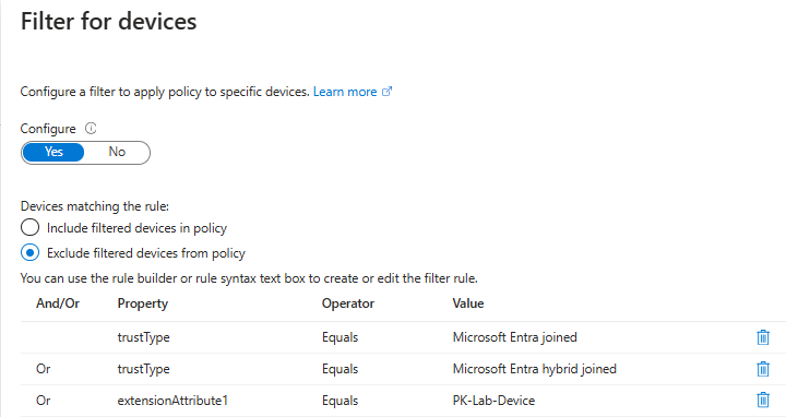

Hi Team,
I have created conditional access policy and targeted to all the user but exclude some of the device using groups.
I have added one custom extension attributes on azure ad registered id and exclude form filter but also don't work.
there is any way to exclude only selected azure ad registered device from CA policy and theses device doesn't exist in Intune portal

  2. Raja Pothuraju 43,750 Reputation points Microsoft External Staff Moderator
    2024-12-17T03:35:21.6366667+00:00
    Hello @Prashant Mishra,
    Thank you for posting your query on Microsoft Q&A.
    Based on the attached screenshots, it appears you are attempting to exclude Azure AD-registered devices from a Conditional Access (CA) policy using the extensionAttribute1 property with the value PK-Lab-Device.

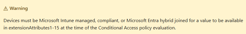

    Even though you have added the extensionAttribute1 property to the exclusion list in the CA policy, it seems the policy is not excluding the device as expected. Please note that when using extensionAttributes, there is a limitation: the devices must be managed by Microsoft Intune for the CA policy to evaluate and exclude them correctly.
    For more details, refer to the document: Supported operators and device properties for filters
    If the devices are not managed by Intune, you can consider the following workarounds: Use other supported device attributes, such as device.trustType: device.trustType -eq "Workplace" or else If you need to target specific devices, you can filter using their deviceId: device.deviceid -eq "aaaaaaaa-0000-1111-2222-bbbbbbbbbbbb".
    If the devices are managed by Intune and the issue persists, let me know, and we can investigate further by verifying the logs offline.
    I hope this information is helpful. Please feel free to reach out if you have any further questions.
