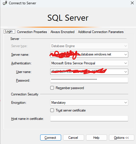

Hello,
I am encountering the following error when trying to connect via Microsoft Entra Service Principal in SSMS. I
-As Username I am using the Application ID. (I tried with dieguitico0007_hotmail.com#EXT#@dieguitico0007hotmail.onmicrosoft.com but it says it is not registered in the default directory. Which is weird since it is.)
-As a password I am using the secret Value
I am getting this
TITLE: Connect to Server
Cannot connect to managementcasesdb.database.windows.net.
ADDITIONAL INFORMATION:
Login failed for user '<token-identified principal>'. (Microsoft SQL Server, Error: 18456)
For help, click: https://docs.microsoft.com/sql/relational-databases/errors-events/mssqlserver-18456-database-engine-error
BUTTONS:
OK

  1. Vijayalaxmi Kattimani 3,410 Reputation points Microsoft External Staff Moderator
    2024-12-18T10:12:16.16+00:00
    Hi @Diego Cedeño,
    Welcome to the Microsoft Q&A Platform! Thank you for asking your question here.
    The error "Login failed for user '' (Microsoft SQL Server, Error: 18456)" when attempting to use a Microsoft Entra Service Principal in SQL Server Management Studio (SSMS) typically indicates a misconfiguration in the Microsoft Entra or SQL Server authentication setup.
    To resolve this, you need to add an AAD user to the Azure SQL Database. you may also need to change the default database option. By default, SSMS attempts to connect to the Master database, where this AAD user may not exist since AAD users are contained within individual user databases.
