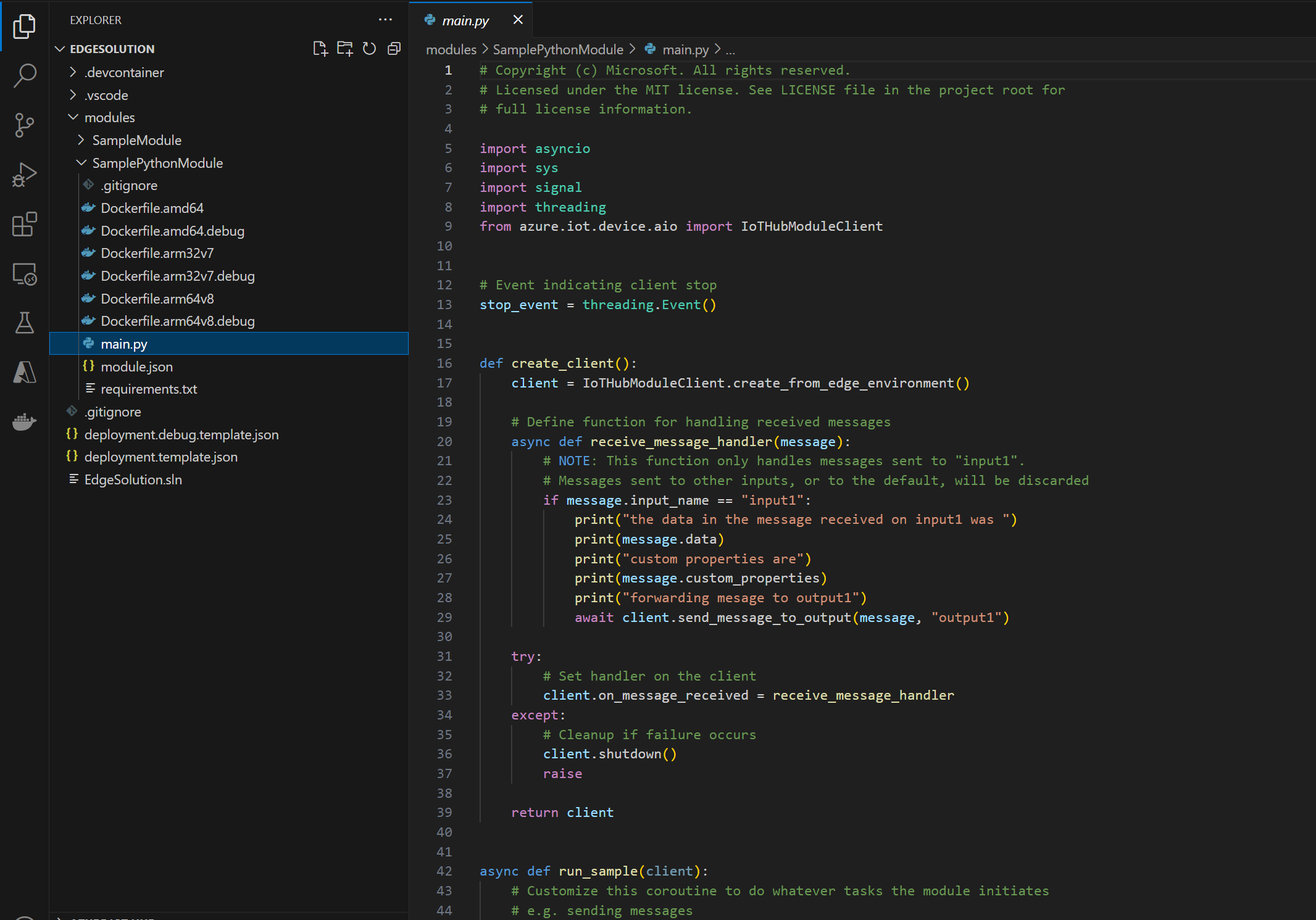

    It is recommended to make use of the Azure IoT Edge module template as seen in the Visual Studio Code extension for Azure IoT Edge:
    This provides automatically the framework for a default module that listens for incoming messages.
    As you can see, it makes use of the:
    client = IoTHubModuleClient.create_from_edge_environment()
    This should be sufficient.
