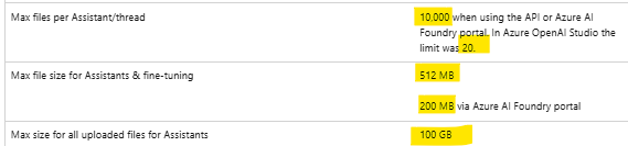

  1. Is there a default time limit or timeout setting in the API that could be impacting the upload of files?
  2. Why am I seeing a difference between the Playground (UI) upload success rate and the API behavior?
  3. Are there additional file size or time restrictions for the Azure OpenAI API when uploading files for Assistant File Search?
    AFAIK, Azure OpenAI service has a maximum file size limit of 512MB per file for uploads and 200 MB via Azure AI Foundry portal. However, there isn't a specific timeout limit mentioned in file uploads. The timeout error you're encountering might be due to network latency or other factors affecting the upload process.
    This depends on your network. The UI might manage requests differently, such as by batching them that reduces the likelihood of hitting server-side limits or timeouts.
    You can find more details for applicable limits on Azure OpenAI Service quotas and limits
