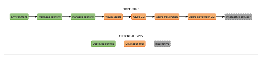

    Hi Richard, you are now working on integrating Azure key vault into your .Net 8 application. So that we have to get the application authorized so that it could access Azure resource. In your code sample, it's using new DefaultAzureCredential() to get authorization. For this method, you might refer to this section.

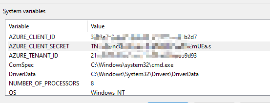

    User's imageAs you can see, credentials can be provided in many steps, setting environment variable is one of the options. You just need to add the required environment variable in windows system, then the
    DefaultAzureCredential method would do authorization task automatically. It firstly checks the environment variable, if failed, then goes into the next step.
