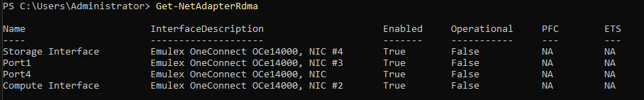

I'm going to create a new Azure stack HCI cluster with 4 new Lenovo server node. Everything is smooth on OS installation, patch and driver installation. But stuck on HCI validation process.
Task: Azure Stack HCI Network
Description:Check network requirements
Details: Failing action plan as execution stuck at: ValidateNetwork step for 10 hours.
Anyone got idea what should i check ?

    Usually users select Group management and compute traffic. For compute and management RDMA capabilities should be disabled and for storage take get-netadapterrdma output if enabled then for storage (intend), you need to select the RDMA enabled as in your case iWrap
    Also cross check if for storage if you have selected default VLAN tagging as 711 and 712 🙂
