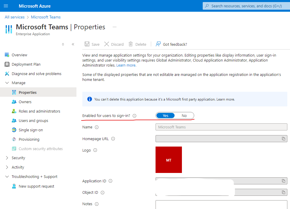

    • Enable the application: In the Azure portal, log in with an administrator account and navigate to Azure Active Directory > Enterprise Applications > Microsoft Teams. Make sure the "Allow users to sign in" option is enabled. (Or turn it off and enable it again) User's image

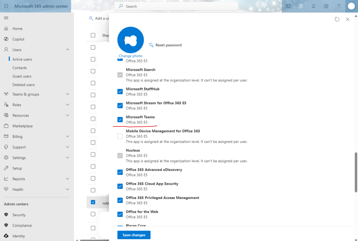

    • Configure licenses: In the Microsoft 365 admin center, make sure that the license permissions for Teams have been assigned to the user. User's image

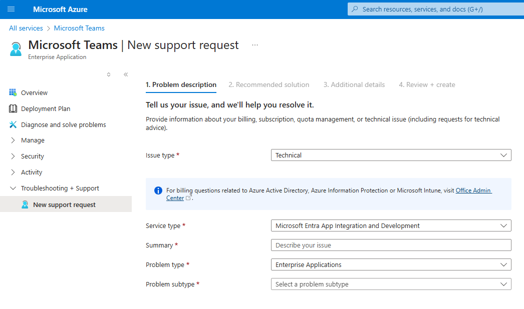

    If these methods still don't work, please submit a support request in the Azure portal or contact phone support for more detailed help.
