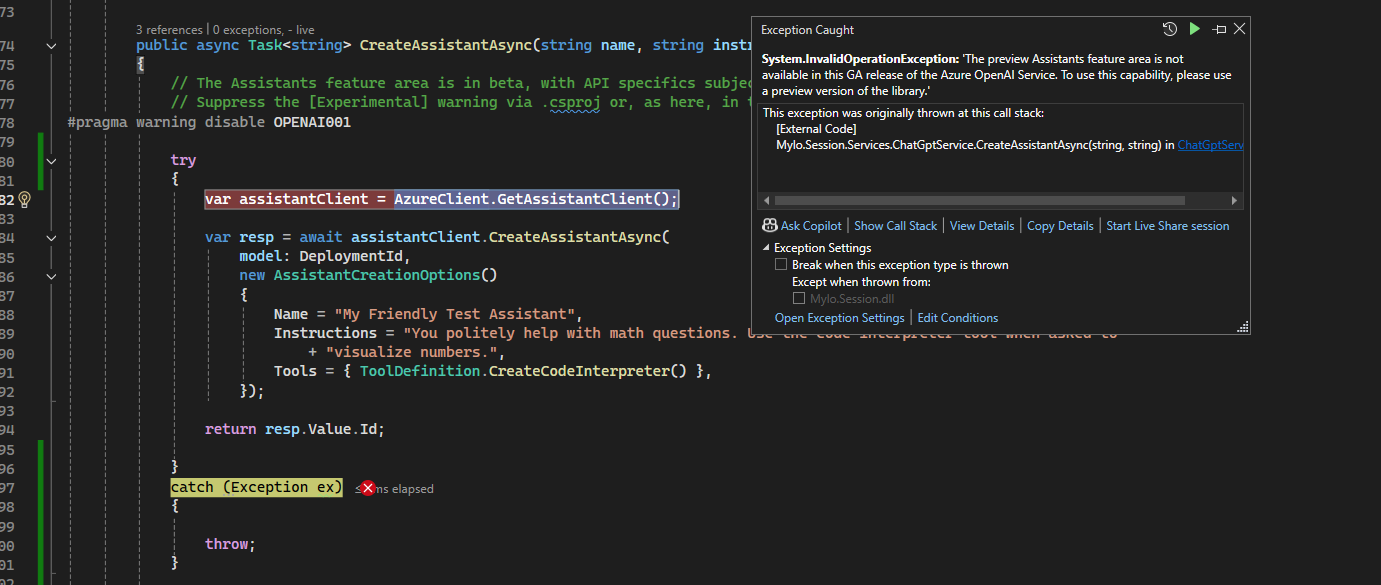

can't create open AI assistance via Azure.AI.OpenAI 2.1.0
Amir 10 Reputation points
2024-12-24T14:43:58.77+00:00
When trying to run AzureClient.GetAssistantClient();
I get an exception
System.InvalidOperationException: 'The preview Assistants feature area is not available in this GA release of the Azure OpenAI Service. To use this capability, please use a preview version of the library.'
I read some in the git that is should be working since 2.0.0
https://github.com/Azure/azure-sdk-for-net/issues/44574

    I have the same problem and nailed it down to a problem on the c# side.
    I was switching between OpenAI and Azure OpenAI back and forth und figured out that the problem was introduced with Azure.AI.OpenAI Nuget package 2.1.0. I have an older test-project using Azure.AI.OpenAI 2.0.0-beta.5 and here the GetAssistantClient and GetVectorStoreClient functions are still working.
    So it's not dependend on the server configuration in Azure AI Foundry.
