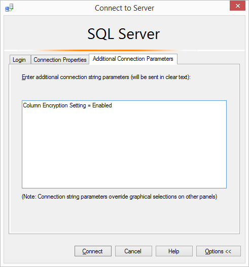

    Step1: In SSMS, you do that when you’re connecting to the instance in the “Connect to Server” dialog. Select “Options”, and go to “Additional Connection Parameters” and enter into the box “Column Encryption Setting = Enabled” – as per the image below:

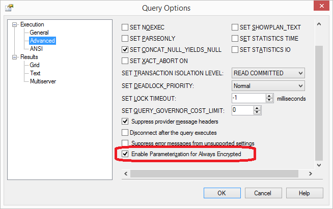

    Step2: Open a new query window against our database, and then we have to actually enable “Parameterization for Always Encrypted”. Right-click over the query and select “Query Options”, then “Advanced” and enable the option as shown below:
    Step3: Get this to work is that you have to rewrite your original query to use variables rather than literal values in the insert. This helps SSMS to be able to manage the rest of the parameterization process.
    Please refer my example from below:
    --insert into table
    DECLARE @fname nvarchar(20)  = 'Kula'
    DECLARE @ename nvarchar(20)  = 'Kalle'
    DECLARE @date smalldatetime='2020-10-10'
     insert into [dbo].[tblPatients] ([FirstName],[LastName],[dob]) values
     (@fname,@ename,@date);
     select * from [dbo].[tblPatients]
    Output:
    --query the value in where condition
    select * from [dbo].[tblPatients]  where [FirstName]=@fname
    Output:
    Note: You have to remove 'ORDER BY LastName, FirstName;' from your procedure otherwise you will get the 'Encryption scheme mismatch' errors.
