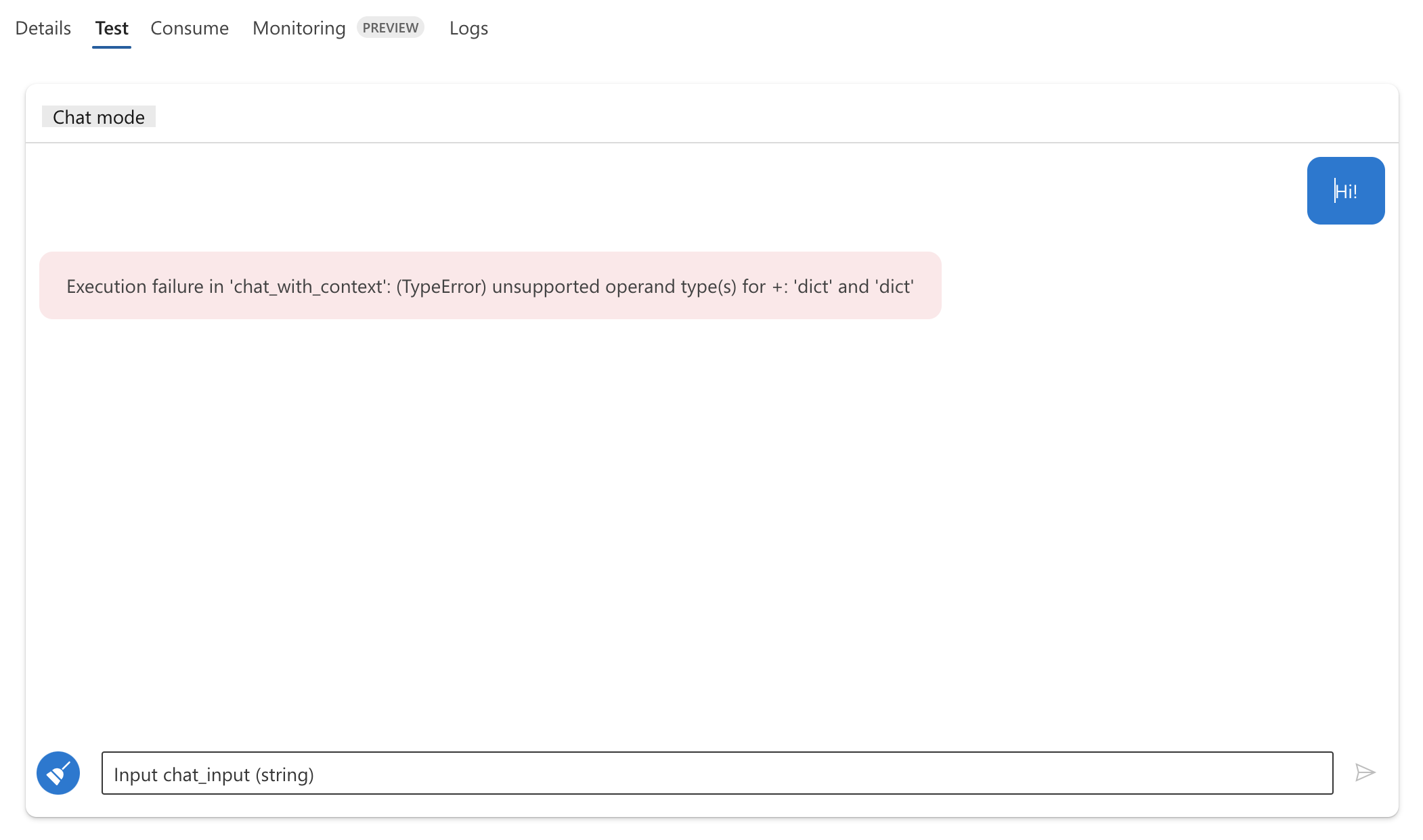

I have tried multiple prompt flows in different ways, but all of them are resulting in same error.
Flow work fine in prompt flow compute session Chat
It also works fine for first time in postman
Second time onwards, it starts throwing error.
I am using gpt-40-mini
unsupported operand type(s) for +: 'dict' and 'dict'
I have researched a lot and it looks like its because of _trace.py calculating tokens, which results in error. Has anyone else solved it.
Here is detailed error: 2024-12-25 12:02:02 +0000 22 execution.flow ERROR Flow execution has failed. Cancelling all running nodes: chat_with_context. [2024-12-25 12:02:02 +0000][pfserving-app][ERROR] - Flow run failed with error: {'message': "Execution failure in 'chat_with_context': (TypeError) unsupported operand type(s) for +: 'dict' and 'dict'", 'messageFormat': "Execution failure in '{node_name}'.", 'messageParameters': {'node_name': 'chat_with_context'}, 'referenceCode': 'Tool/promptflow.executor.flow_executor', 'code': 'UserError', 'innerError': {'code': 'ToolExecutionError', 'innerError': None}, 'additionalInfo': [{'type': 'ToolExecutionErrorDetails', 'info': {'type': 'TypeError', 'message': "unsupported operand type(s) for +: 'dict' and 'dict'", 'traceback': 'Traceback (most recent call last):\n File "/azureml-envs/prompt-flow/runtime/lib/python3.9/site-packages/promptflow/executor/flow_executor.py", line 1344, in wrapper\n return f(*args, **kwargs)\n File "/azureml-envs/prompt-flow/runtime/lib/python3.9/site-packages/promptflow/tracing/_trace.py", line 562, in wrapped\n token_collector.collect_openai_tokens_for_parent_span(span)\n File "/azureml-envs/prompt-flow/runtime/lib/python3.9/site-packages/promptflow/tracing/_trace.py", line 143, in collect_openai_tokens_for_parent_span\n merged_tokens = {\n File "/azureml-envs/prompt-flow/runtime/lib/python3.9/site-packages/promptflow/tracing/_trace.py", line 145, in <dictcomp>\n key: (self._span_id_to_tokens[parent_span_id].get(key, 0) or 0) + (tokens.get(key, 0) or 0)\nTypeError: unsupported operand type(s) for +: 'dict' and 'dict'\n', 'filename': '/azureml-envs/prompt-flow/runtime/lib/python3.9/site-packages/promptflow/tracing/_trace.py', 'lineno': 145, 'name': '<dictcomp>'}}], 'debugInfo': {'type': 'ToolExecutionError', 'message': "Execution failure in 'chat_with_context': (TypeError) unsupported operand type(s) for +: 'dict' and 'dict'", 'stackTrace': '\nThe above exception was the direct cause of the following exception:\n\nTraceback (most recent call last):\n File "/azureml-envs/prompt-flow/runtime/lib/python3.9/site-packages/promptflow/executor/flow_executor.py", line 1034, in _exec\n output, aggregation_inputs = self._exec_inner_with_trace(\n File "/azureml-envs/prompt-flow/runtime/lib/python3.9/site-packages/promptflow/executor/flow_executor.py", line 937, in _exec_inner_with_trace\n output, nodes_outputs = self._traverse_nodes(inputs, context)\n File "/azureml-envs/prompt-flow/runtime/lib/python3.9/site-packages/promptflow/executor/flow_executor.py", line 1215, in _traverse_nodes\n nodes_outputs, bypassed_nodes = self._submit_to_scheduler(context, inputs, batch_nodes)\n File "/azureml-envs/prompt-flow/runtime/lib/python3.9/site-packages/promptflow/executor/flow_executor.py", line 1270, in _submit_to_scheduler\n return scheduler.execute(self._line_timeout_sec)\n File "/azureml-envs/prompt-flow/runtime/lib/python3.9/site-packages/promptflow/executor/_flow_nodes_scheduler.py", line 131, in execute\n raise e\n File "/azureml-envs/prompt-flow/runtime/lib/python3.9/site-packages/promptflow/executor/_flow_nodes_scheduler.py", line 113, in execute\n self._dag_manager.complete_nodes(self._collect_outputs(completed_futures))\n File "/azureml-envs/prompt-flow/runtime/lib/python3.9/site-packages/promptflow/executor/_flow_nodes_scheduler.py", line 160, in _collect_outputs\n each_node_result = each_future.result()\n File "/azureml-envs/prompt-flow/runtime/lib/python3.9/concurrent/futures/_base.py", line 439, in result\n return self.__get_result()\n File "/azureml-envs/prompt-flow/runtime/lib/python3.9/concurrent/futures/_base.py", line 391, in __get_result\n raise self._exception\n File "/azureml-envs/prompt-flow/runtime/lib/python3.9/concurrent/futures/thread.py", line 58, in run\n result = self.fn(*self.args, **self.kwargs)\n File "/azureml-envs/prompt-flow/runtime/lib/python3.9/site-packages/promptflow/executor/_flow_nodes_scheduler.py", line 181, in _exec_single_node_in_thread\n result = context.invoke_tool(node, f, kwargs=kwargs)\n File "/azureml-envs/prompt-flow/runtime/lib/python3.9/site-packages/promptflow/_core/flow_execution_context.py", line 90, in invoke_tool\n result = self._invoke_tool_inner(node, f, kwargs)\n File "/azureml-envs/prompt-flow/runtime/lib/python3.9/site-packages/promptflow/_core/flow_execution_context.py", line 206, in _invoke_tool_inner\n raise ToolExecutionError(node_name=node_name, module=module) from e\n', 'innerException': {'type': 'TypeError', 'message': "unsupported operand type(s) for +: 'dict' and 'dict'", 'stackTrace': 'Traceback (most recent call last):\n File "/azureml-envs/prompt-flow/runtime/lib/python3.9/site-packages/promptflow/_core/flow_execution_context.py", line 182, in _invoke_tool_inner\n return f(**kwargs)\n File "/azureml-envs/prompt-flow/runtime/lib/python3.9/site-packages/promptflow/executor/flow_executor.py", line 1344, in wrapper\n return f(*args, **kwargs)\n File "/azureml-envs/prompt-flow/runtime/lib/python3.9/site-packages/promptflow/tracing/_trace.py", line 562, in wrapped\n token_collector.collect_openai_tokens_for_parent_span(span)\n File "/azureml-envs/prompt-flow/runtime/lib/python3.9/site-packages/promptflow/tracing/_trace.py", line 143, in collect_openai_tokens_for_parent_span\n merged_tokens = {\n File "/azureml-envs/prompt-flow/runtime/lib/python3.9/site-packages/promptflow/tracing/_trace.py", line 145, in <dictcomp>\n key: (self._span_id_to_tokens[parent_span_id].get(key, 0) or 0) + (tokens.get(key, 0) or 0)\n', 'innerException': None}}} [2024-12-25 12:02:02 +0000][pfserving-app][INFO] - Finish monitoring request, request_id: b42748db-9db5-4c52-9a45-4cf3fd2c3fa1, client_request_id: 542443f3-7049-4b7b-9f7b-dc117afe56b1.

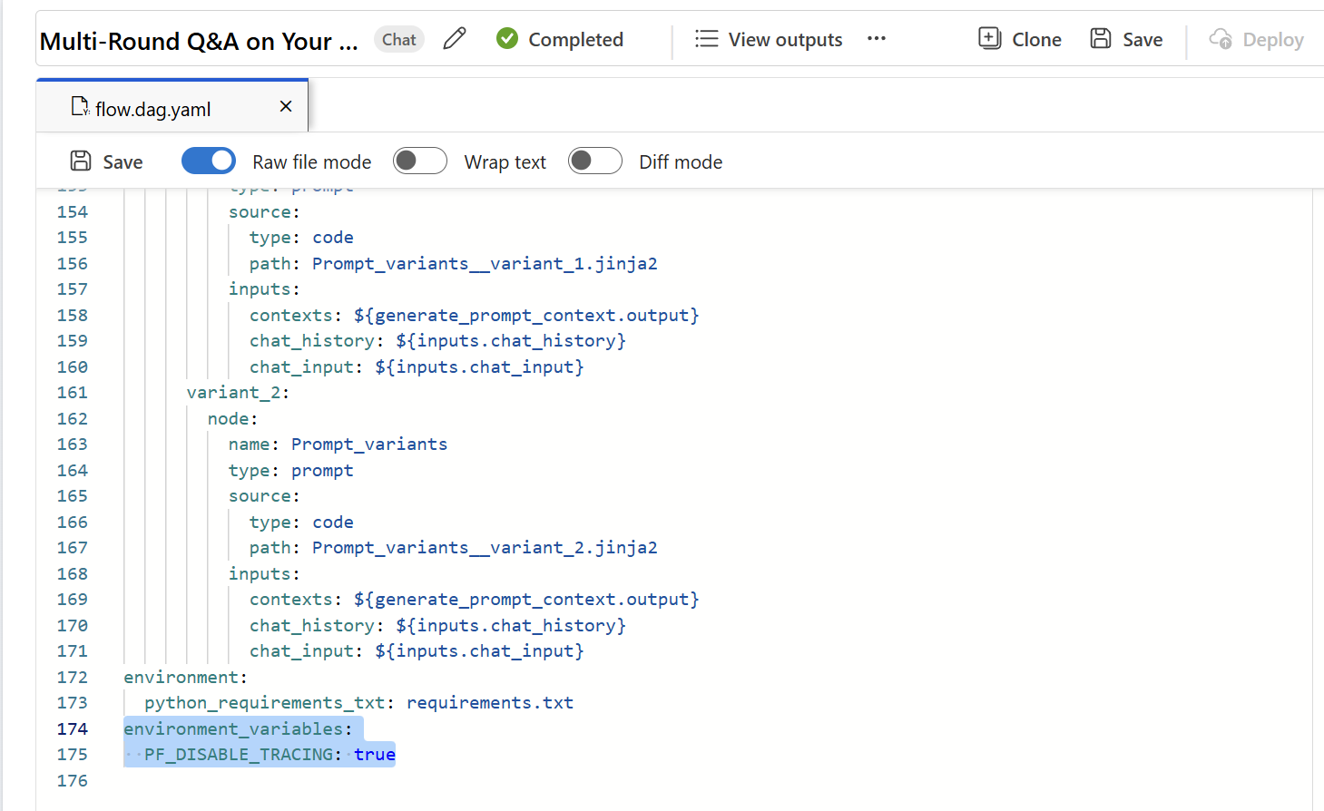

  1. Ziggy Zulueta 495 Reputation points MVP
    2025-01-17T02:49:24.8966667+00:00
    I was able to solve this issue by going to the Prompt flow, selecting raw file mode to on, and inserting the statement:
    environment_variables:
    PF_DISABLE_TRACING: true
