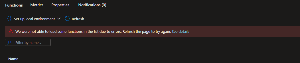

I am trying to debug this issue where the inclusion of the Microsoft.Graph SDK is causing the azure function app host run time to fail.
Running the function app in debug mode locally I have no issues using Microsoft Graph to access the data I need. It is only after deploying the app that I receive an error in Azure:
User's image User's image
I am using Azure Identity alongside Microsoft.Graph to access Sharepoint through ClientSecretCredentials. Only one class/project has these dependencies:

    This error message you shared indicates that the host runtime is unable to start the function app due to an internal server error.
    To troubleshoot this issue, you can try the following steps:
    1. Check the Azure Function App logs to see if there are any additional error messages that can provide more information about the issue. You can access the logs from the Azure portal by navigating to your Function App, selecting "Functions" from the left-hand menu, selecting your function, and then selecting "Logs" from the top menu.
    2. Check if there are any issues with the Azure Identity or Microsoft.Graph packages. You can try removing these packages and deploying the function app again to see if the issue persists. If the issue goes away, then it is likely that there is an issue with one of these packages.
    3. Check if there are any issues with the Azure Function App Isolated Worker Net 8.0. You can try deploying a simple function app without the Azure Identity or Microsoft.Graph packages to see if the issue persists. If the issue goes away, then it is likely that there is an issue with the Azure Function App Isolated Worker Net 8.0.
    4. Try using Dependency Injection to manage the Azure Identity and Microsoft.Graph packages. This can help to ensure that the packages are properly initialized and configured before they are used in your function app.
