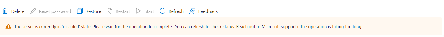

Hi one of my project project's Azure Database for MySQL flexible server is stuck in the disabled state. I can't Start or Restart the server again. User's image
This DB subscription was automatically renewed two days ago, and I suspect this happened after that. Rest of the resources in the subscription is currently active and works without an issue.
Resource health is not reporting any issues.

    Hi @Isuru Akalanka,
    Welcome to the Microsoft Q&A Platform! Thank you for asking your question here.
    Could you please let us know from how long this error has been appearing in your database? did you try with CLI/Powershell?
    If you have not tried with CLI/Powershell, Please follow the below mentioned steps and execute using CLI:
    To start a server, run the az mysql flexible-server start command. If you use local context, you don't need to provide any arguments.
    Usage:
    az mysql flexible-server start [--name]
                                   [--resource-group]
                                   [--subscription]
    Example without local context:
    az mysql flexible-server start  --resource-group --name myservername
    Example with local context:
    please refer to the mentioned link for more information.
    https://learn.microsoft.com/en-us/azure/mysql/flexible-server/how-to-restart-stop-start-server-cli?source=recommendations
    If the above steps do not resolve the issue, I recommend you to file a support ticket for deeper investigation and do share the SR# with us? In case if you don't have a support plan, please let us know here.
