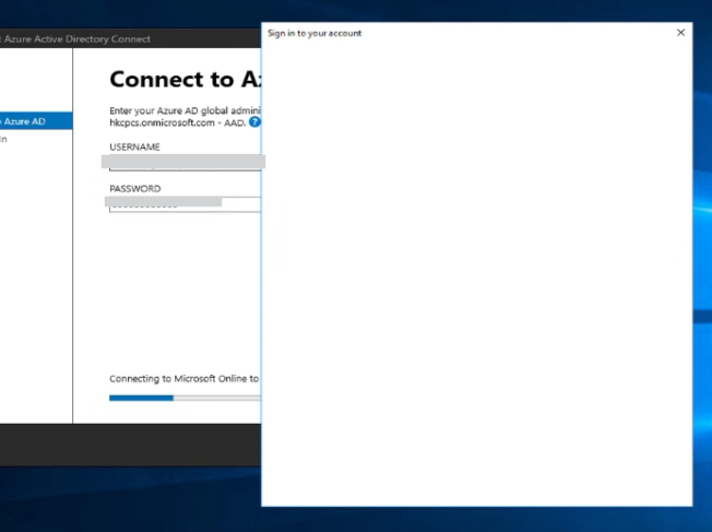

I'm receiving a blank page when trying to Sign in to Account during Entra Connect Sync upgrade/install. I've tried to do the Ctrl+/- but that doesn't work.
I have tried (re/un)installing the connect sync app but can't get pas the blank Sign in screen.

    Based on your description, it seems you are encountering a blank login screen when modifying Azure AD Connect settings or during installation. To ensure we're aligned, I've attached a screenshot for clarification.
    Unfortunately, there isn't a direct solution for this issue; it requires investigating several factors to determine the root cause. Additionally, this doesn't seem to be strictly related to an Entra Connect sync issue.

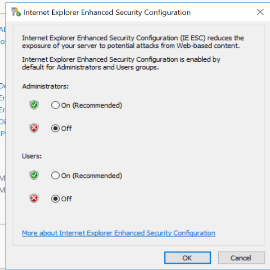

    3. Change the IE Enhanced Security settings to “No.” User's image

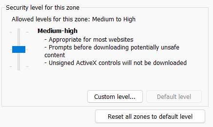

    7. Open inetcpl.cpl, navigate to the Security tab, and adjust the security level settings to “Low.” Then, test again. User's image
