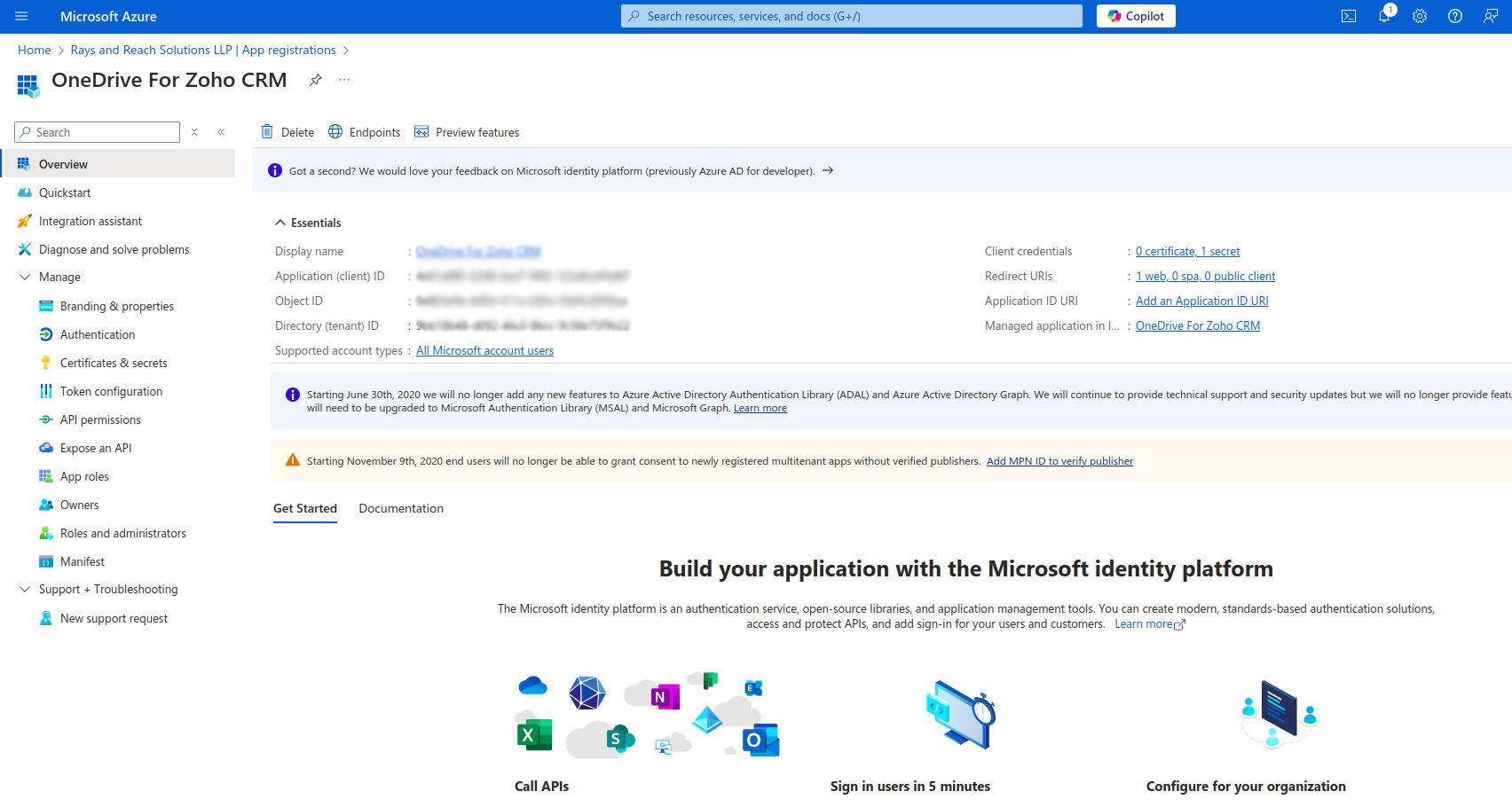

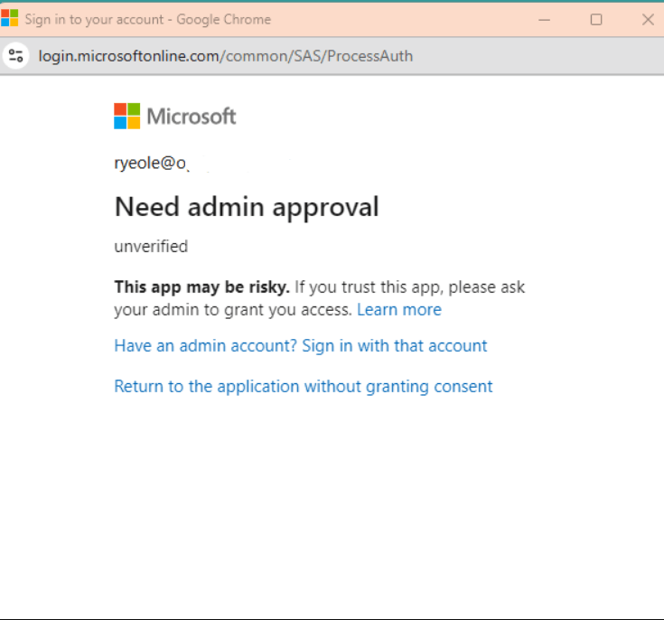

We encounter the problem "Need admin approval" when we try to authorize OneDrive using oauth 2.0. The below urls are used
Auth URL: https://login.microsoftonline.com/common/oauth2/v2.0/authorize
Access Token URL:https://login.microsoftonline.com/common/oauth2/v2.0/token
Scope: offline_access files.readwrite.all
Clientid and clientsecrets are created using microsoft azure portal of free trail account.
The screenshot of authorization issue

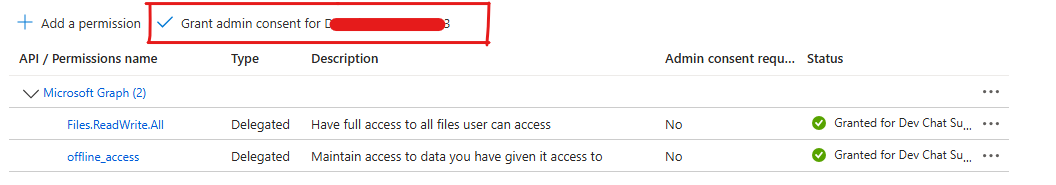

    Hi @Mageshwari SS
    Try logging into your MS Entra ID as a global admin, then find the calling app and grant admin consent for the above permissions.

  1. Vasil Michev 119.6K Reputation points MVP Volunteer Moderator
    2025-01-03T07:24:19.79+00:00

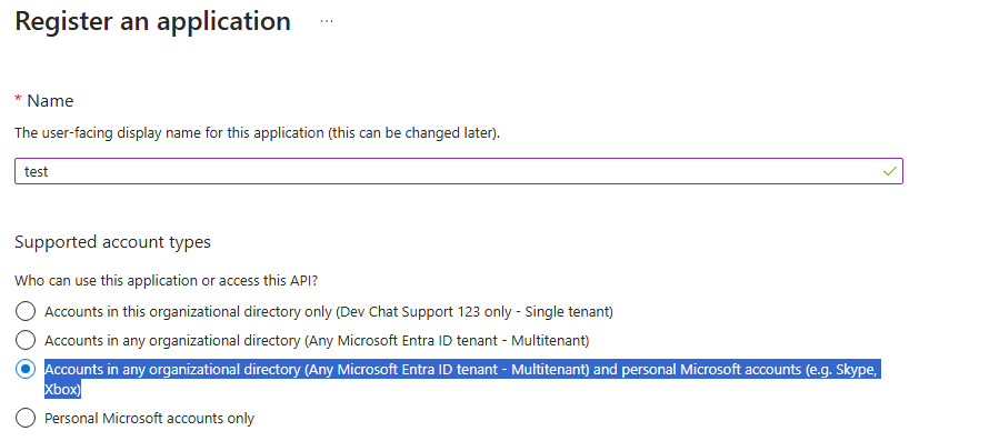

    A while back, Microsoft started enforcing the need for admin consent for any "risky" apps, such as ones from unverified publishers. If this is an application you plan to use across multiple tenants, it is best to provision it within a proper, paid tenant, with the Publisher verification process completed. If it's an app you plan to use in your own tenant, provision it therein as a single-tenant application instead.
