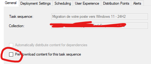

After adding a machine to the collection, I would like all the sources for the task sequence to be downloaded in the background before launching the task sequence. Specifically, I mean the files that appear after a user clicks on "Install."
The first package contains a few scripts, and the second one contains the OS upgrade package. This setup with cache downloaded would allow the installation to proceed faster.
I looked at the deployment options and saw the following options:
and
Unfortunately, none of these options work. When the task sequence appears in the Software Center, no downloading occurs, even after a long time...

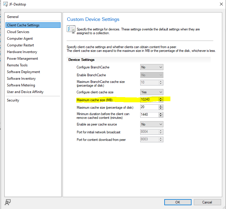

The program for deployment "TT020198" ("TT000420" - "") requires content to be downloaded, but there is insufficient cache memory. The current cache size is 10240 MB, of which 7114 MB is available. The current available disk space on the cache volume is 172051 MB. This program requires 7919 MB of available space in the cache. Workaround: Increase the cache size, or remove other content from the cache, or increase the amount of available disk space. This program will not be retried.*

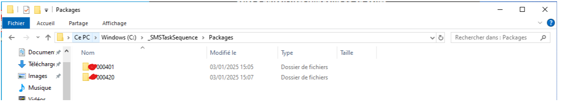

I don't understand why the message above mentions a cache issue, given that the Task Sequence normally downloads all the packages it uses to C:\_SMSTaskSequence and not to C:\Windows\CCMCache.
This behavior is unclear to me.

    Kindly check if there is any error in the CAS.log. The Content access service(CAS) is used to request pre-cache package contents for the available in-place upgrade deployment. The content access service(CAS) verifies whether the SCCM cache has enough space to accommodate the package download. The SCCM client cache size should accommodate the content. For your scenario, we can increase the cache size to 15GB to have a try.

  1. Izanagi76 240 Reputation points
    2025-01-08T16:38:07.5333333+00:00
    Thanks a lot for your reply,
    You mean by changing below option ?
