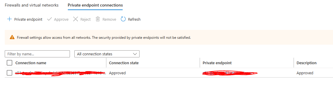

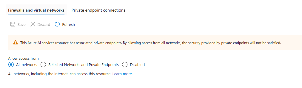

2025-01-07T13:36:17.3533333+00:00 Thanks for the response. I had a feeling it would be a firewall block as well but I got a response from my ticket this morning saying they don't see any block.
I also checked our resource's network tab and don't see anything that may be causing the issue.
As far as trying ipv4 instead of ipv6, how do I go about doing that?
navba-MSFT • 27,545 Reputation points • Microsoft Employee • Moderator
2025-01-07T13:42:59.4033333+00:00 @Michael Lanctot Thanks for sharing the screenshot. I see that you have a private endpoint enabled. This issue could be due to the private endpoint as well.
