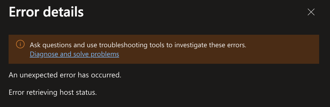

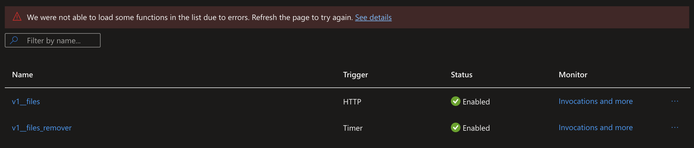

But when I set the authentication to OpenID connect with "HTTP 302 found redirect" (when set to return 401 everything works for me), it's like the function lost access to storage. The vscode extension shows no files in the function (even though they were there before setting the authentication and everything worked normally), the function shows an error (see screenshot) and when I try to manually run the timer trigger (v1__files_remover) it returns 401. User's imageUser's image
Is there something I'm doing wrong here?
Thank you

  1. Václav Parma 40 Reputation points
    2025-01-05T12:35:35.4+00:00
    It turns out that the authentication configuration must include this:
    excludedPaths: [
       '/admin/*'
    So the whole authentication then looks like this:
    resource filesFunctionAuthSettings 'Microsoft.Web/sites/config@2024-04-01' = {
      parent: filesFunction
      properties: {
        platform: {
          enabled: true
        globalValidation: {
          requireAuthentication: true
          unauthenticatedClientAction: 'RedirectToLoginPage'
          redirectToProvider: 'AZURE_AD_B2C'
          excludedPaths: [
            '/admin/*'
        identityProviders: {
          customOpenIdConnectProviders: {
            AZURE_AD_B2C: {
              registration: {
                clientId: EntraClientID
                clientCredential: {
                  clientSecretSettingName: 'AZURE_AD_B2C_AUTHENTICATION_SECRET'
                openIdConnectConfiguration: {
                  wellKnownOpenIdConfiguration: b2cConfigurationUrl
        login: {
          tokenStore: {
            enabled: true
      dependsOn: [
        filesFunction
        deploymentScript
    And then everything works as it should.
