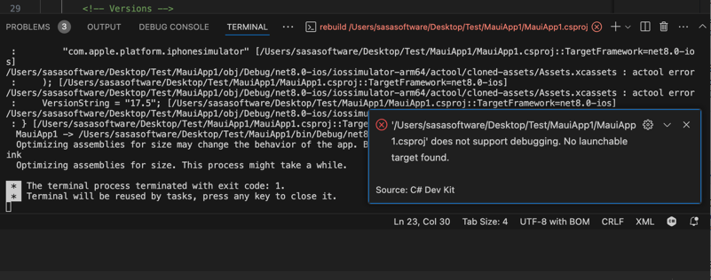

Maui app in mac using VS Code stop working.
I got this error.
Using .Net 8.
What's the debug target? Do you run the app on an iOS simulator? If so, what's the Xcode version?
I selecte the project to run in MAC and from menu run the app with/without debugging
and I got this image error above.

the error is pretty clear. when compiling to release (AOT) one of your dependent library is not supported. You might try:
<UseInterpreter>true</UseInterpreter>
in the release build.

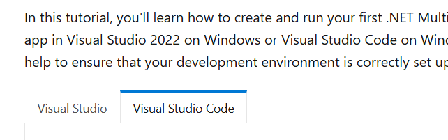

Please follow the guide on the official doc- Build your first .NET MAUI app - .NET MAUI | Microsoft Learn. (Select the Visual Studio Code tab)
The doc speak about VS i do not see VS code.
here
thanks.

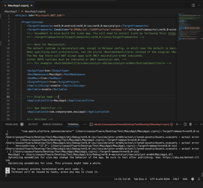

I succeded to creare new poject. but not running.
more info.
the default project template includes windows, iOS and android targets. this means you either install all the build tools for each platform or edit the project file to limit the targets to only what you want.

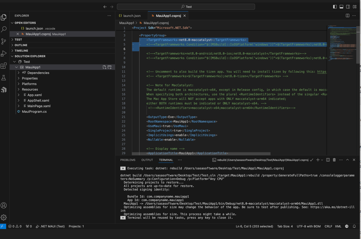

I limited the target only for new Maui project to macalist as below:
and got same error:
what do i miss ? my project , not the new maui project work before ?

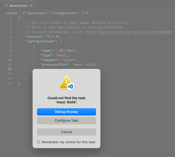

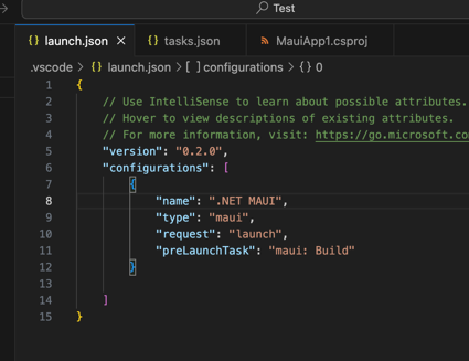

my launch .json of the new maui project

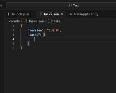

my task.json of the new maui project
This after clear nd rebuild my project:
also the task json is empty in my project like the empty project.
and launch.json is like the empty project.
are they define correctly? if not how?

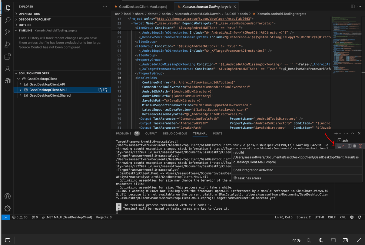

The error says that the referenced package OpenGLES does not support the MacCatalyst framework.
I have no such reference.

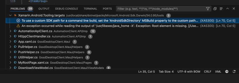

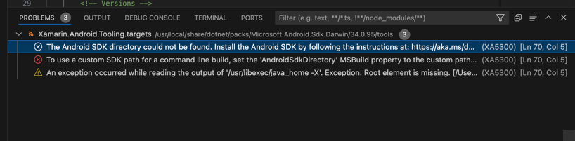

Go to the 'PROBLEM'tab, I saw there are 36 issues. Could you provide the log in txt?
Your quick answer will be appreciated
This shows that there is an Android SDK error, please follow the doc to install- Install .NET for Android dependencies - .NET for Android | Microsoft Learn

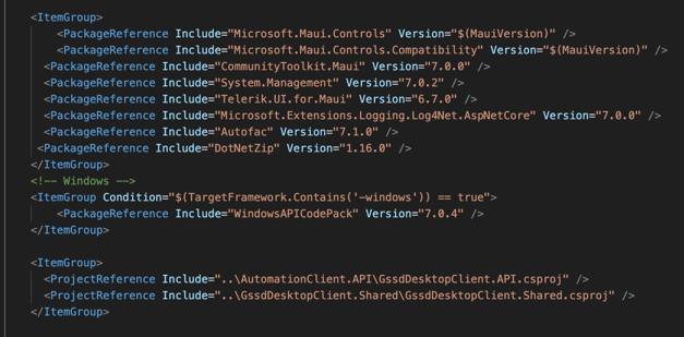

Form the image, I see you add two project references in your project, do you also add these references when creating a new project for testing?
1.regarding the Android sdk, , I'm in MAC what is the c is it correct ?
Can you please give the path in MAC for p:AndroidSdkDirectory +
p:JavaSdkDirectory.
from where i run this cmd?
dotnet build -t:InstallAndroidDependencies -f net8.0-android -p:AndroidSdkDirectory=c:\work\android-sdk -p:JavaSdkDirectory=c:\work\jdk -p:AcceptAndroidSdkLicenses=True

3.I do not added these references when creating a new project for testing.

regarding 1:Is this the full command in MAC? sasasoftware is my user.
dotnet build -t:InstallAndroidDependencies -f net8.0-android \
-p:AndroidSdkDirectory=/Users/sasasoftware/Library/Android/sdk \
-p:JavaSdkDirectory=/Library/Java/JavaVirtualMachines/jdk-17.jdk/Contents/Home \
Your quick answer will be appreciated.
No, you could save the SDK in /Users/XXX/Library/Developer/Xamarin/android-sdk-macosx/...There is another way to configure Android, click "View" on the top bar, select "Command Palette"->.NET MAUI Configure Android.
Since it cost a long time, and we still cannot find the root issue, it is recommended to open a support ticket for this. Please contact our paid phone support at MS Support. You will get 1:1 support on that.
I do not have this command paallete:

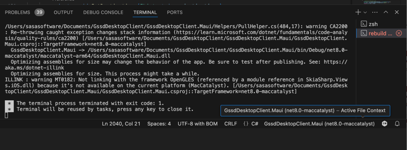

In my project I removed the target .net8.0-android && net 8.0-ios and the Android SDK error disapper. but still got this error:
ILLINK : warning MT0182: Not linking with the framework OpenGLES (referenced by a module reference in SkiaSharp.Views.iOS.dll) because it's not available on the current platform (MacCatalyst). [/Users/sasasoftware/Documents/GssdDesktopClient/GssdDesktopClient.Maui/GssdDesktopClient.Maui.csproj::TargetFramework=net8.0-maccatalyst]

I have reproduced the warning
Sample maui project just added the SkiaSharp.Views.Maui.Controls and Compatibilityreference and called .UseSkiaSharp inside the MauiProgram.cs file.
I have reproduced the warning Sample maui project just added the SkiaSharp.Views.Maui.Controls and Compatibilityreference and called .UseSkiaSharp inside the MauiProgram.cs file.
It means the root issue is the SkiaSharp issue as Bruce said. Are there any updates about the packages? Or could you update MAUI version? Or update C# Dev Kit?

Telerik tested this issue on net 9, same behavior, there is a warning with Skia 2.88.7 version. They updated the Skia to the latest version 3.116.1 and there isn't a warning.
