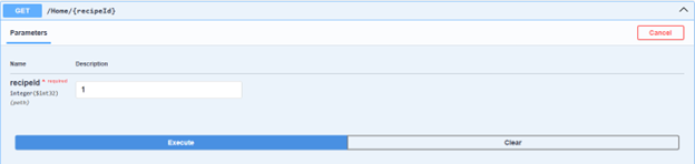

    Call and get directly in [HttpGet("{recipeId}")]
    public async Task<ActionResult> GetAverageRatingForRecipe(int recipeId)
              return Ok(_dbContext.GetRecipeAverageRating(recipeId));

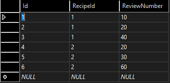

    Assume your table structure and data are as follows:Picture1 Test Results:
