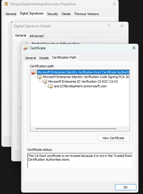

  4. When I right-click on the executable, visit the "Digital Signatures" tab, select the signature, and click the "Details" button it says: "A certificate chain processed, but terminated in a root certificate which is not trusted by the trust provider."

    After setting up certificate profile, please follow this guide to sign with Trusted Signing: https://learn.microsoft.com/en-us/azure/trusted-signing/how-to-signing-integrations We don't pull certs from AKV.
  3. Meha-MSFT 1,165 Reputation points Microsoft Employee Moderator
    2025-01-09T19:45:45.9633333+00:00
    Please follow the guide on how to sign with Trusted Signing and you should be all set. Trusted Signing certificates are default trusted on supported Windows versions with latest security updates, so there's no need for additional EV/OV certs or anything you need to extra to trust the CA.
