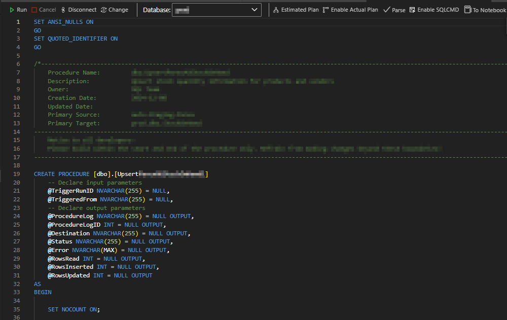

Using script activity, my DF executes my stored procedure (SP) written in X.
When SP performs a merge from dbx.Table1 to dby.Table1 --> Failure (Authorization issue as stated in question)
When SP performs a merge from dbx.Table1 to dbx.Table2 --> Success
When SP performs a merge from dby.Table1 to dby.Table2 --> Success

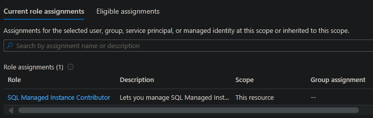

My authorization setup:
Using a system-managed identity, DF is assigned as SQL Managed Instance Contributor to MIUser's image
Inside both dbx and dby, I executed these commands:
CREATE USER [DF] FROM EXTERNAL PROVIDER;
ALTER ROLE db_datareader ADD MEMBER [DF];
ALTER ROLE db_datawriter ADD MEMBER [DF];
GRANT SELECT TO [DF];
GRANT INSERT, UPDATE, DELETE TO [DF];
GRANT EXECUTE TO [DF];
GRANT CREATE TABLE TO [DF];
GRANT ALTER TO [DF];
