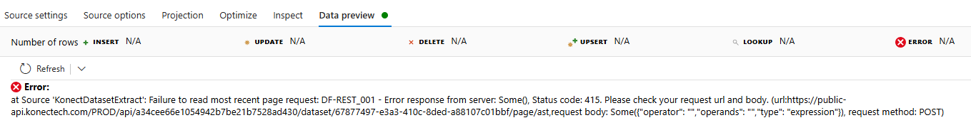

When I try to do the data preview, I am getting the following error:
Error: at Source 'KonectDatasetExtract': Failure to read most recent page request: DF-REST_001 - Error response from server: Some(), Status code: 415. Please check your request url and body. (url:https://public-api.konectech.com/PROD/api/a34cee66e1054942b7be21b7528ad430/dataset/67877497-e3a3-410c-8ded-a88107c01bbf/page/ast,request body: Some({"operator": "","operands": "","type": "expression"}), request method: POST)

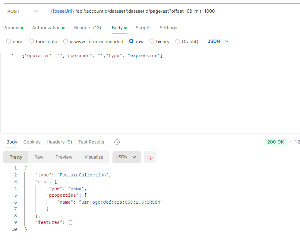

I am using a self-hosted IR and Azure managed VNet. The API works well when I keep the body empty, but when I add the json given above, it throws this error. Also, the same json works well in the postman.

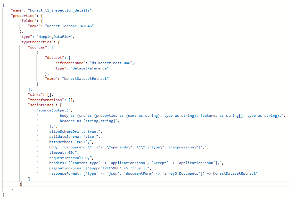

    The code of the data flow is as follows:
Error screengrab:

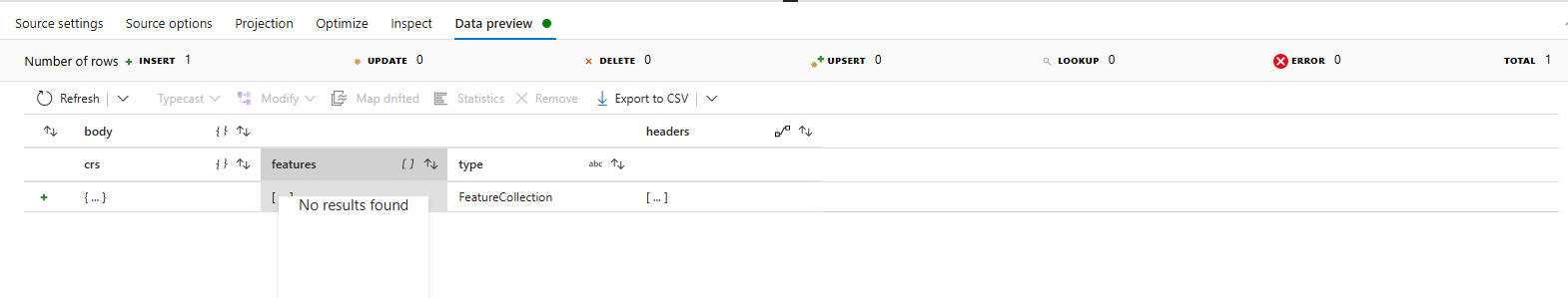

Please note that if I keep the body empty, I do get a success response like so:
Success response:

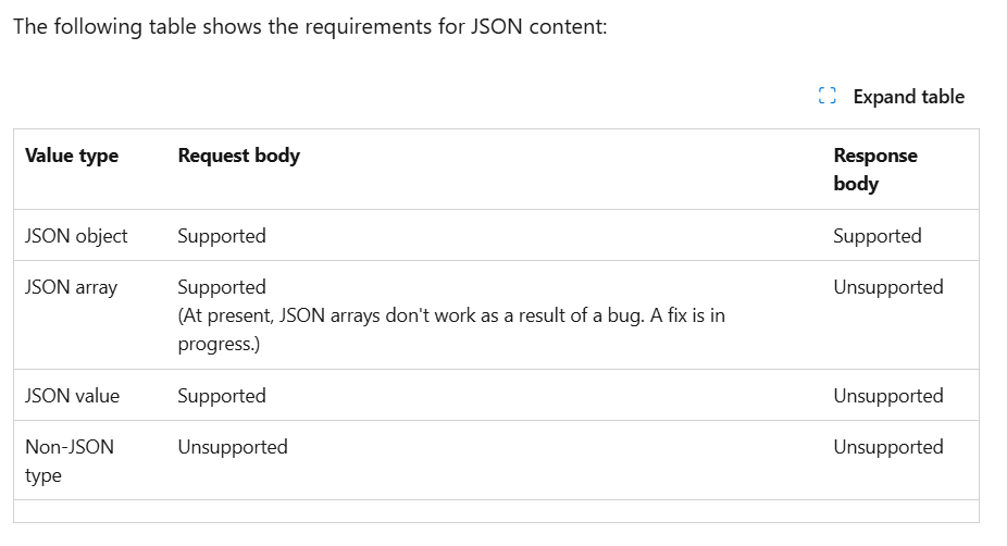

Is it due to a known bug that is mentioned in Microsoft's official documentation here?
https://learn.microsoft.com/en-us/azure/data-factory/control-flow-web-activity#type-properties

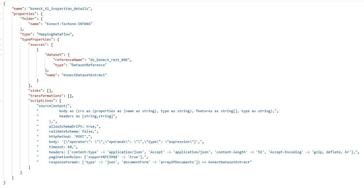

I have also tried to add additional headers like content-type, accept, content-length and accept-encoding, but I am getting the following error:
at Source 'KonectDatasetExtract': Failure to read most recent page request: Request Failure(URL:https://public-api.konectech.com/PROD/api/a34cee66e1054942b7be21b7528ad430/dataset/67877497-e3a3-410c-8ded-a88107c01bbf/page/ast); Error Message: null; shaded.msdataflow.org.apache.http.client.ClientProtocolException
Screengrab of definition with extra headers:
