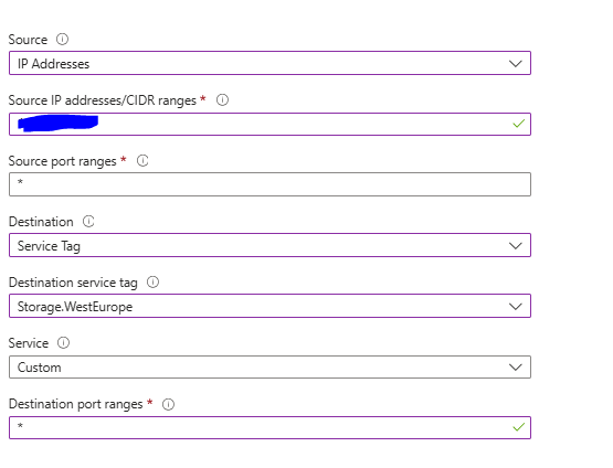

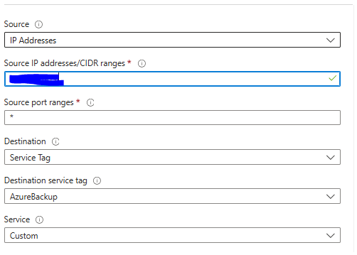

Hello,
I blocked the internet on my Azure VM. After blocking the internet, the Azure SQL server backup became unreachable. I followed the article mentioned below.
https://learn.microsoft.com/en-us/azure/backup/backup-sql-server-database-azure-vms#establish-network-connectivity
Create the Azure backup and Azure Storage NSG and trigger the manual backup. Backup triggered successfully but failed to transfer in the vault. Does anyone have any idea how to fix the issue?
