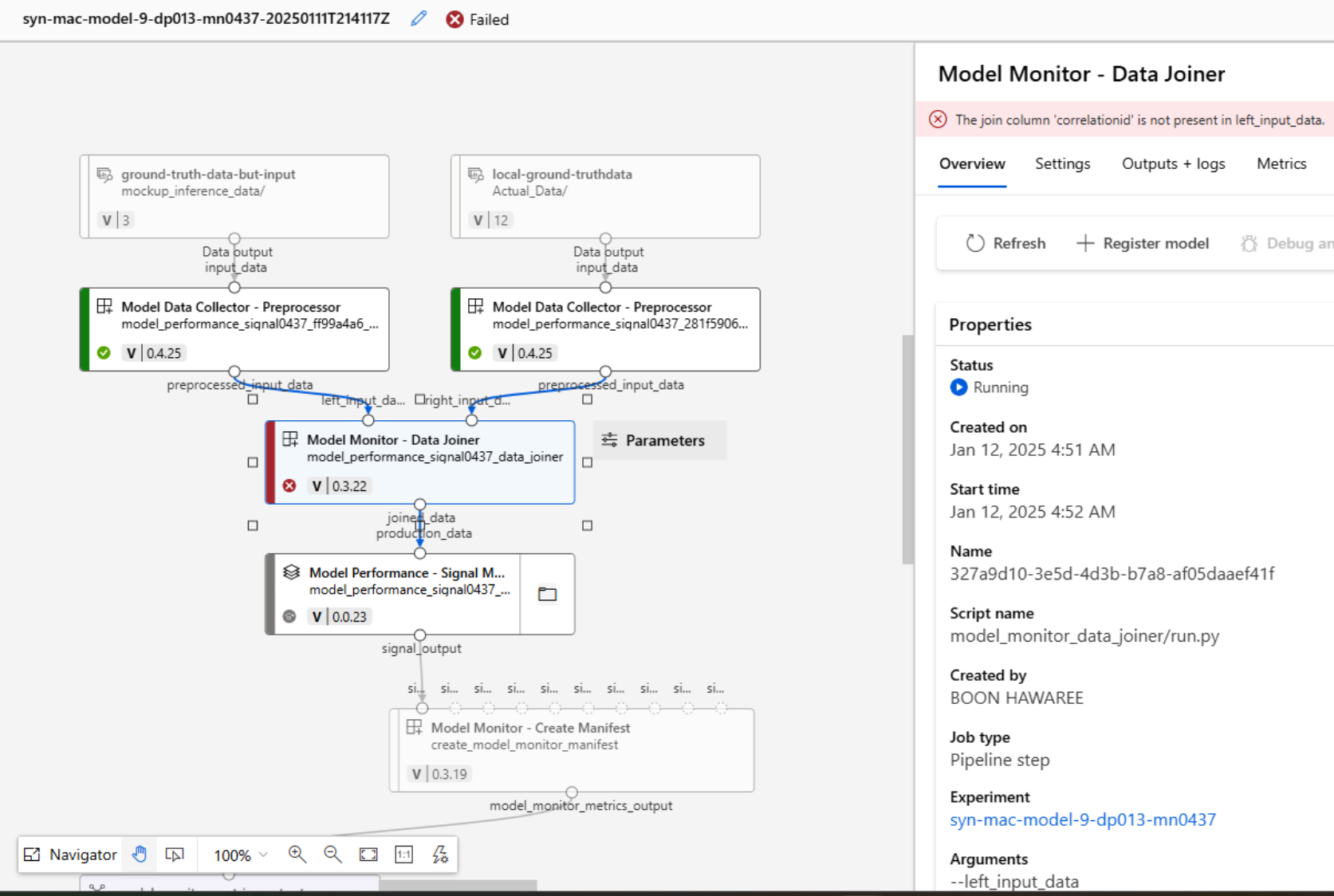

failed job at data joiner

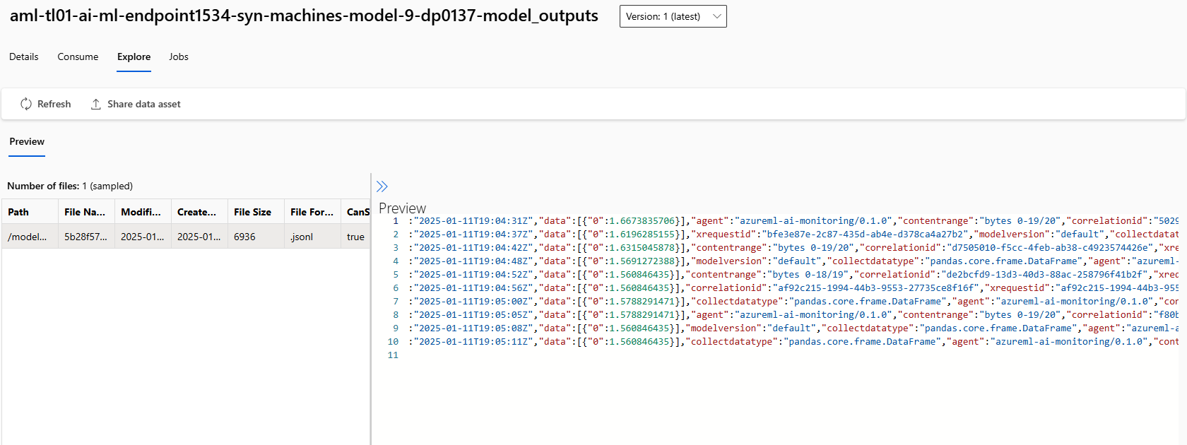

Left_input_data is the deployed model's inference output data, which were collected as data assets in the AML blob by enabling the data collector, as shown below.
left_input_data

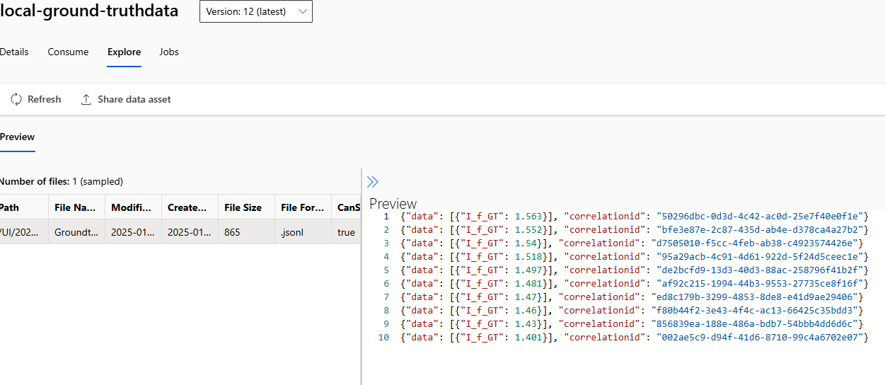

The right_input_data is the ground truth data uploaded from my local. The format can be seen below.
right_input_data

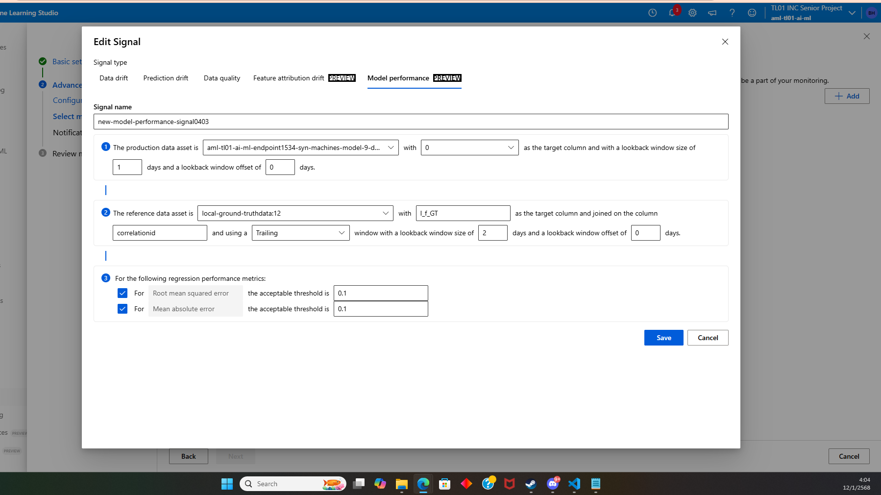

The image below is the configuration of the monitoring signal. signal configuration

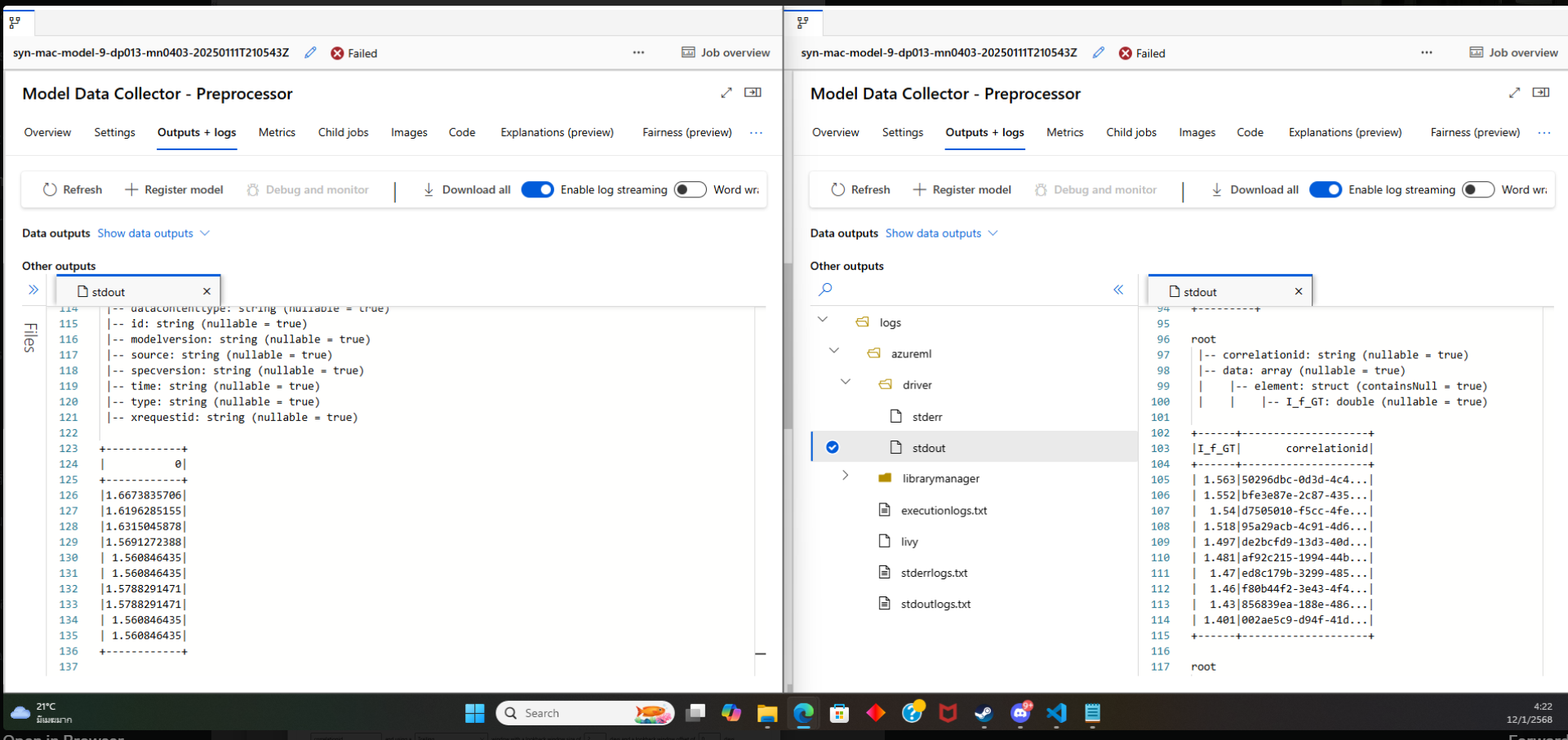

After the error ("join column 'correlationid is not present in left_input data.") occurred, I tried to troubleshoot it and found out that the output of the preprocessing job between the left and right side was different. The correlationid column was somehow missing. As shown in the image below. (column name 0)
missing correlation id on the left side

PS. The correlationid between the left and right input are matched as the right input were made up by me.
