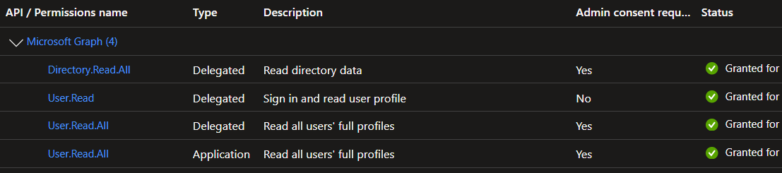

I have a requirement to upload csv files into onedrive personal using python in non-ineractive way. I have created an app registration in my Azure tenant with below API permissions
Type:
Accounts in any organizational directory (Any Microsoft Entra ID tenant - Multitenant) and personal Microsoft accounts (e.g. Skype, Xbox)"
API Permissions:
Screenshot 2025-01-14 075129
My Code:

Error message:
Error uploading file: {'error': {'code': 'BadRequest', 'message': 'Tenant does not have a SPO license.', 'innerError': {'date': '2025-01-14T02:15:47', 'request-id': 'cf70193e-1723-44db-9f5e-xxxxx', 'client-request-id': 'cf70193e-1723-44db-9f5e-xxxx'}}}
How to solve this ? Please note, I need to use a non-interactive way as this has to be setup on an ubuntu server to run the script on daily basis and upload the CSV files to personal onedrive.
