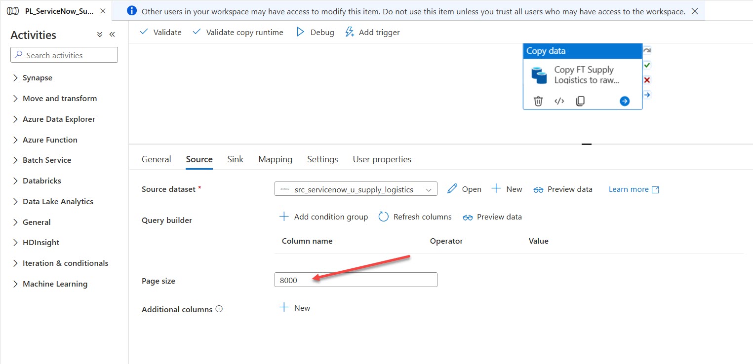

    Update: I was just playing with the settings myself. I lowered the pagesize to 7000, and with the second attempt it just ran a time without errors.
    Will keep monitoring......
