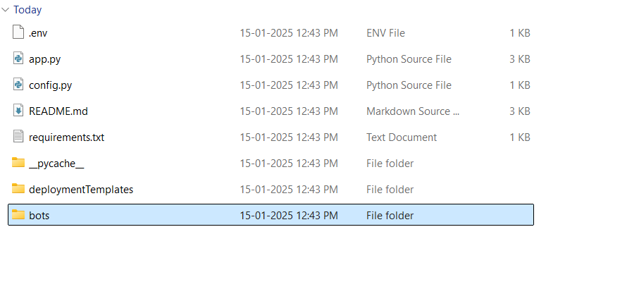

I am using zip file for the deployment, here is the zip file contents
Screenshot 2025-01-15 124324
And no I am not including the root folder in the zip file.
i am zipping the files inside
BotBuilder-Samples\samples\python\02.echo-bot\

    You will need to ensure compatibility between gunicorn and the bot, and avoids potential pitfalls in deployment. By aligning the file structure, port configurations, and startup command, the bot will deploy successfully to Azure App Service.
    These are the steps you will need to take:
    1. Keep the file structure simple and align it with how gunicorn expects the main module. Place echo_bot.py in the same directory as app.py, and update import statements accordingly.
    2. Set the WEBSITES_PORT to 8000 (the default for gunicorn) in the ARM template:
             "name": "WEBSITES_PORT",
             "value": "8000"
      Update config.py (or equivalent configuration file) to use port 8000 instead of 3978: "port": 8000
    3. Modify the gunicorn startup command in the ARM template to explicitly include the port:
         gunicorn --bind 0.0.0.0:8000 --worker-class aiohttp.worker.GunicornWebWorker --timeout 600 app:APP
    4. Ensure the requirements.txt file lists all dependencies accurately and check that the app service logs for errors using bash command: az webapp log tail --resource-group <your-resource-group> --name <your-app-name>

    1. Make sure that all necessary dependencies are listed in the requirements.txt file. This file should be at the root of your zip file.
    2. Check that the file structure inside your zip file is correct. The requirements.txt and your main application file (e.g., app.py or bot.py) should be at the root level of the zip file.
