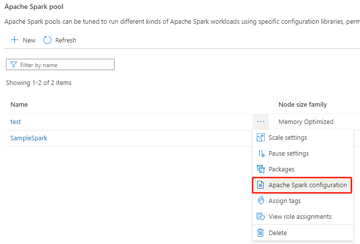

    1. Check Spark Pool Configuration: Ensure that the Spark pool configuration hasn't changed. Verify the number of nodes, node size, and auto-scaling settings. Screenshot that apache spark configuration.

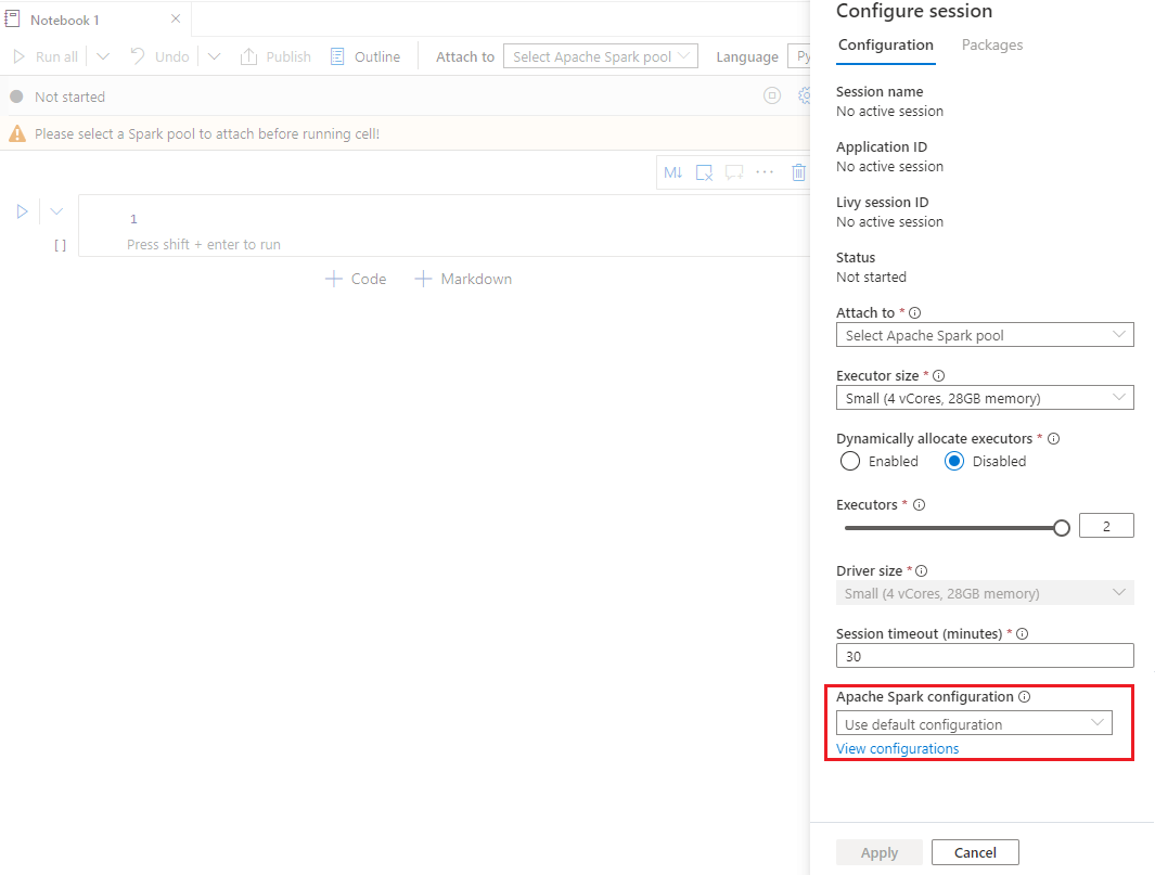

    2. Resource Utilization: Monitor the resource utilization of your Spark pool. High CPU or memory usage might indicate that the pool is under heavy load, causing delays. Screenshot that create configuration in configure session.
