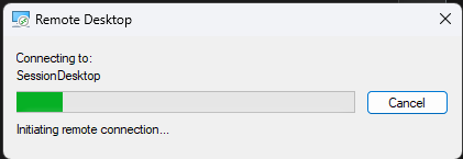

- Remote Desktop Client Issue:
- I am using the "Remote Desktop" client recommended by Microsoft. (https://learn.microsoft.com/en-us/azure/virtual-desktop/users/connect-remote-desktop-client?tabs=windows)
- I can log into the client and see the VM listed.
- However, when I try to connect, it gets stuck in an initialization loop and never progresses.

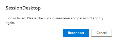

- Web Portal Issue:
- When I attempt to connect via the web portal (https://client.wvd.microsoft.com/arm/webclient/index.html), I receive the following error: "SessionDesktop: Sign in failed. Please check your username and password and try again."
- This error occurs regardless of whether I use Entra ID SSO or manually enter the username and password.

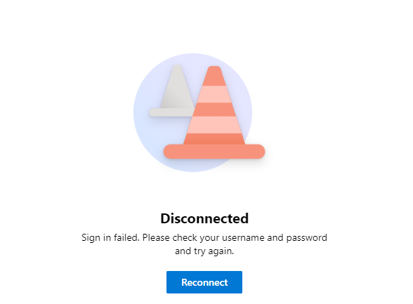

- Windows App Issue:
- I also tried connecting using the Windows App Portal (https://windows365.microsoft.com/ent#/devices)
- When attempting to connect, I receive the following error: "Disconnected: Sign in failed. Please check your username and password and try again."
- To rule out user error, I am copying passwords directly from a password manager to ensure they are correct.

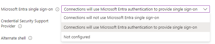

- Authentication and Policies:
- The Entra ID logs show no authentication errors.
- Per-user MFA is disabled.
- Conditional Access Policies (CAPs) that involve MFA are configured to exclude Azure Virtual Desktop and Azure Windows VM sign-ins.
