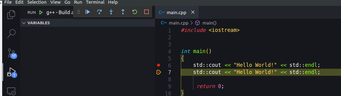

on my Linux machine, I am using a robot in a simulation program (ROS) and C++ code controls it. Debugging is working on my Linux machine using Visual studio code.
Here I attached the process using Visual Studio Code
Here is the debugging using Visual Studio Code on Linux

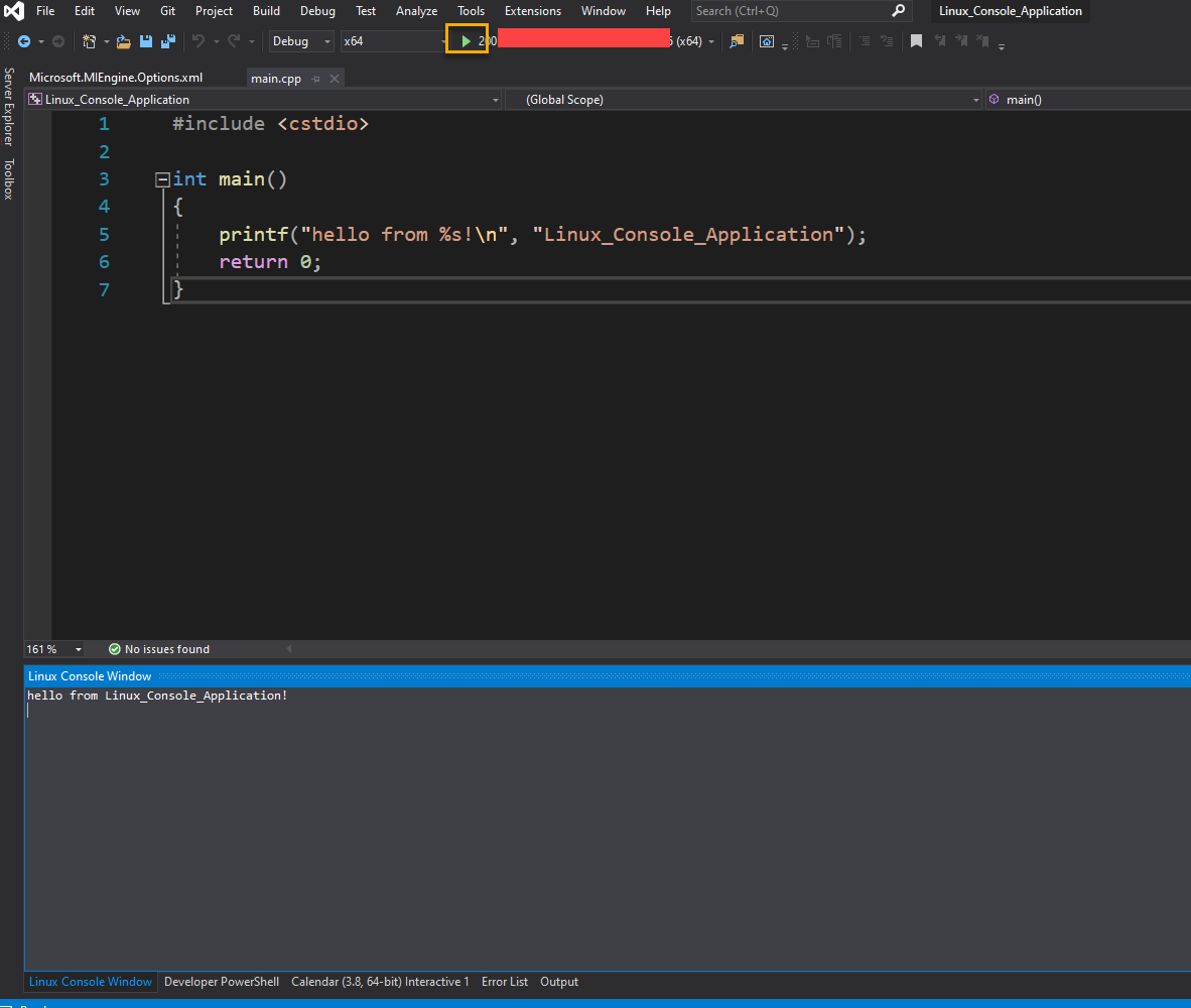

    I created "Linux Console Application" and made a SSH Connections to the my Linux machine.
    I see the following page as a default page in Visual Studio 2019. When I clicked the run button (green arrow inside yellow rectangle in the picture ), then I see the output in Linux Console Window.
    Now on the linux machine , I created a simple C++ Program named 'main.cpp' in Visual Studio Code.

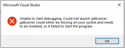

    then I see 2 different types of debugging;
    If I select native GDB, , then I got the following error,
