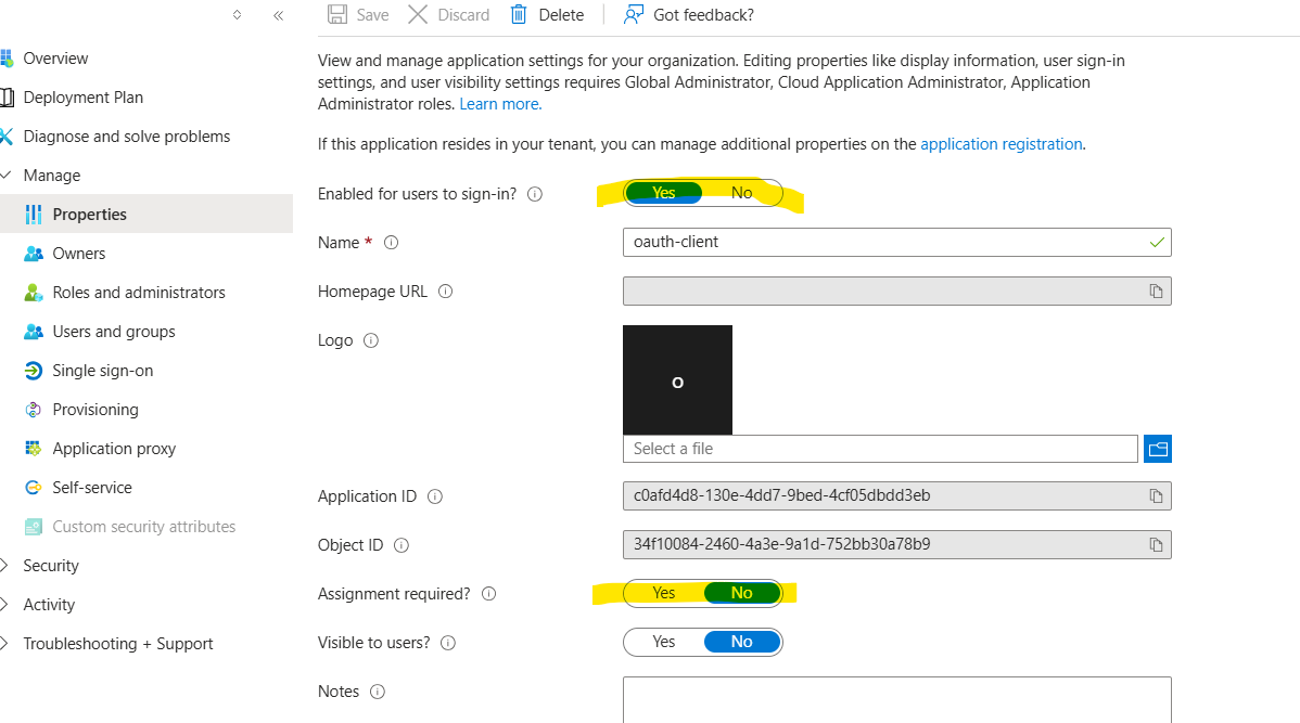

However, even though in Entra admin center I had "Assignment required" set to Yes for the application, I found that I could still login with a different MS user account, that was not assigned.

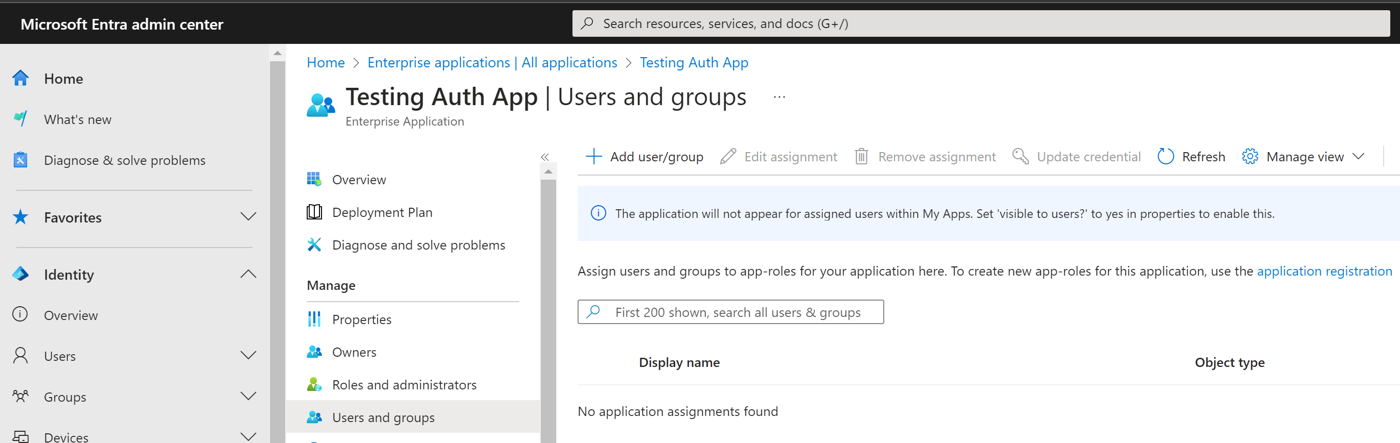

Even with no assigned users, I could still sign in with any user:

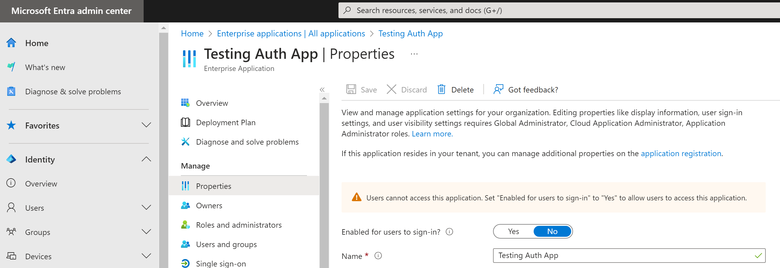

I even went so far as to set "Enabled for users to sign-in" to No.
But I could STILL login to my app using Microsoft. Tried clearing the cache in Edge, made no difference - I could still login.
