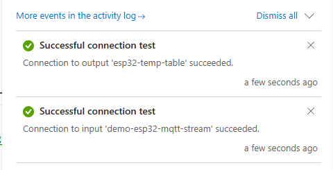

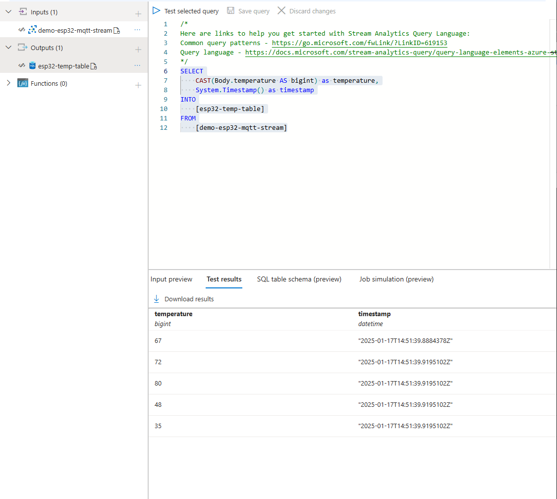

My next goal is to route the data to a database. To achieve this, I created and connected the input, query, and output in Stream Analytics. I also tested the connections and verified the query.
Here is the query I tested:
However, after checking the database, I found it empty. Only one row has been created.

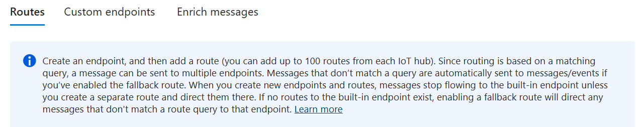

    You connect the Stream Analytics job via the 'eventhub compatible endpoint' of the Azure IoT Hub.
    And you added a custom route for the blobs.
    By adding that route, you triggered a 'side effect', that eventhub compatible endpoint turns into a fallback route scenario:

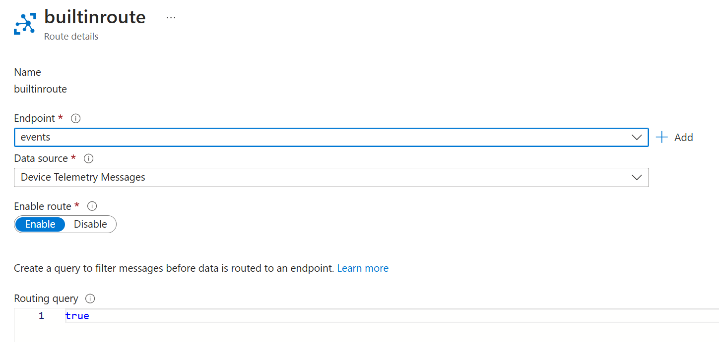

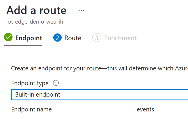

    The solution is easy:
    Just add an extra (second) route for the build-in endpoint and you have your flow back:
    Check the text on the message routing about more details.
